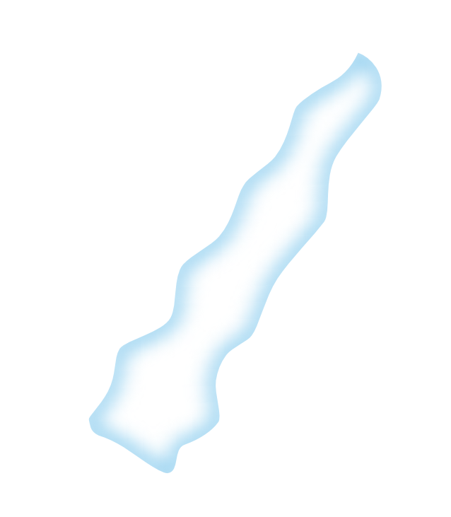

I don't want a rectangular gradient, that was just for demonstration purposes. Fortunately I found an answer.
Step 1: draw shape
step 2: duplicate it
step: 3 use Path > Dynamic Offset then click and drag LMB outwards.
Step 4: Create new layer move shape into it then lock new layer
Step 5: Give outside shape fill color then set strokes to have no color.
Step 6: Set shape opacity to 35%
Step 7: Lock layer and unlock previous layer.
Step 8: Duplicate open layer
(You will now have three layers)
Step 9: Set desired stroke color in middle layer and leave fill with no color
Step 10: Set stroke width to desired value and set blur to 3.5
Step 11: Unlock top layer and select both inside shapes.
Step 12: Use Object > Clip > Set.
Step 13: Delete underlying fill color
And there you go, the process actually does not involve gradients at all but the end result looks like it does.

Re: How to fit an inverted gradient to a shape?
Hello:
Your method is good.
Even more, There are other methods to simulate the same effect.
- One is using the interpolate extensiob between the path and its offset as you have done. But some things get automatized. A better explanation here:
http://tavmjong.free.fr/INKSCAPE/MANUAL ... nterpolate
- Other is duplicating, offseting, bluring the path, and then cliping it. There are more steps involved.
And maybe there are more
