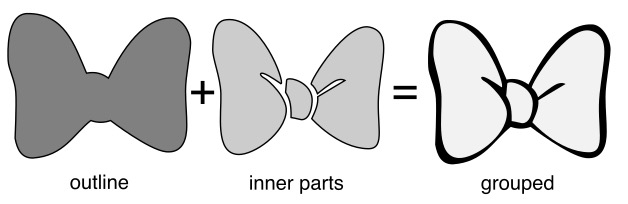

But simply draw a fresh bow over it: one outline on the outer edges and 3 white parts for the inner portions combined to a "compound path" or grouped when a solid fill color is needed.

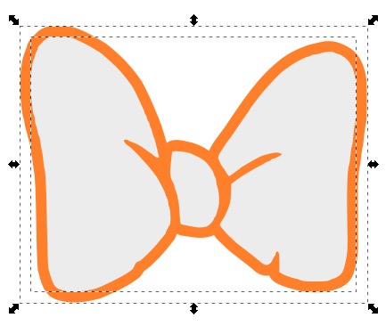

I'd just use the bucket tool to fill the area in the bow with an object (or rather, three of them). Then I would combine the three into one object (Path > Combine). After that, I'd add a small black border to the new object, so there is no gap towards the original black border. Then I would add the pattern fill to the object. I would perhaps also change the order of the stroke and the fill in the 3rd tab of the Fill and stroke dialog, to get the largest possible area of 'bow contents'.

Works fine for me (with a bit of gaps closing, threshold adjustment and modification of stroke width).

Yeah - I took the bucket fill tool with its default settings in first place. What works quite well is to use an increased threshold+ fill Boolean-added to one object as the contour and a second fill at 0,00:
