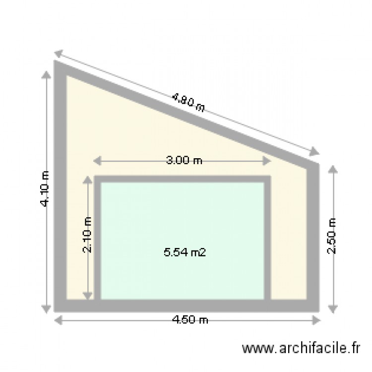

With an example it is maybe clearer
- b01a2f83b25f45d1-750E750.jpg (40.37 KiB) Viewed 783 times
