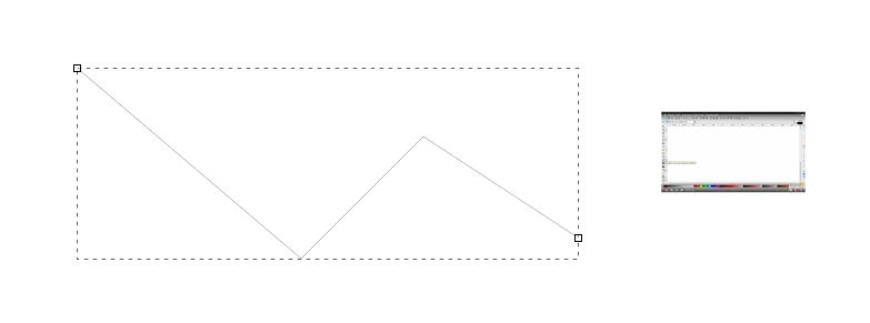

To create a straight line, I select the Bezier Tool, left-click, release mouth, drag, ..., left-click again, and hit enter. And, it works!
But, sometimes, when I hit enter, a copy of the Inskscape window appears:
What happened?
Thank you!

(1) Yes, it appears on the canvas next to the object. Both are outside the document.
(2) It stays there, it can be selected, and delete it.
(3) The Bezier Tool Controls show that the First Control (Create path) is selected and that the Shape is set to From clipboard.
(4) On the canvas, there is the object drawn, the image, and the document. In the post, I show the object and the image. The image is a copy of the entire screen.

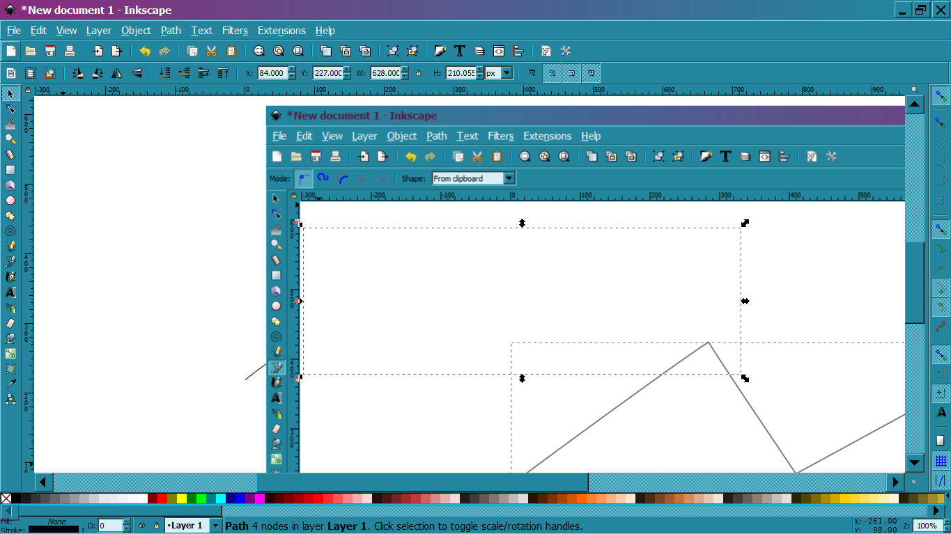

Whoa!! I've reproduced it..... I think.
1 - Using the Windows accessory, called Snipping tool, I dragged around the entire Inkscape window, then Edit menu > Copy
2 - In Inkscape, in Regular Bezier mode (also happens in Straight Line mode, didn't test other modes), with From Clipboard in the Shape dropdown menu
3 - Draw a random path, and instead of double-clicking to end the path, click once, then press Enter key
4 - The entire Inkscape window which was copied, is pasted onto the canvas
The difference is that what I got was the full size window. And DrT's screenshot shows it quite small. But maybe he or she had a small version of it on his or her clipboard? Hopefully attached is a screenshot of my result.
You can't actually see the path, because the pasted image of the whole window is covering it up. But you can see the bounding box.
I guess Inkscape can't use an image on the clipboard as pattern along path, so it just pastes the image??
But it has to be a bug, right?
- fc.png (133.95 KiB) Viewed 1529 times

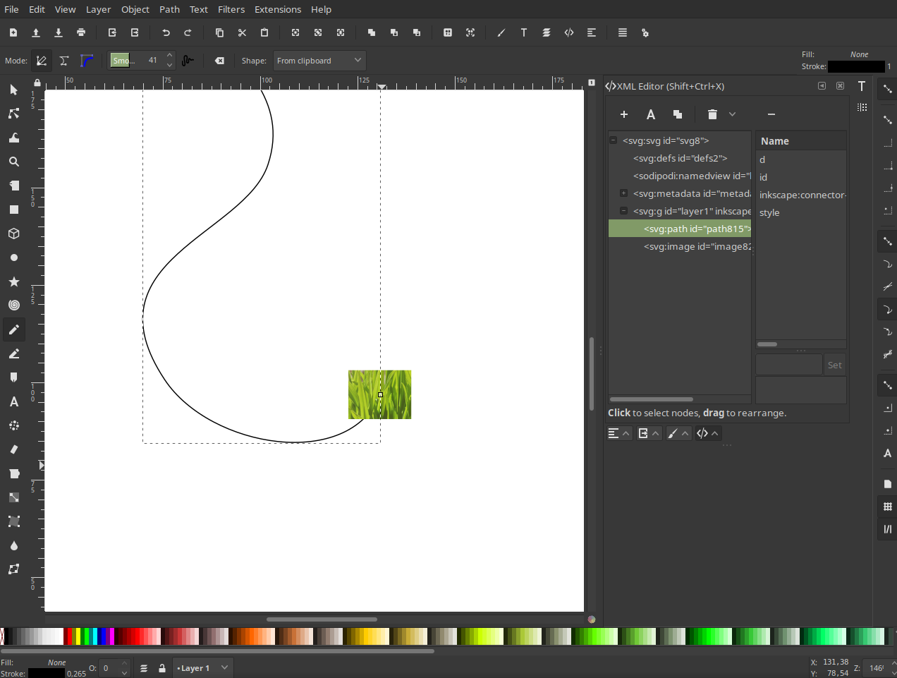

- Bildschirmfoto_2018-11-27_02-46-57.png (108.96 KiB) Viewed 1521 times
