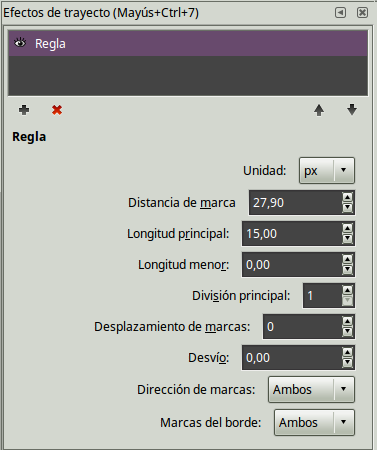

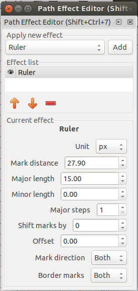

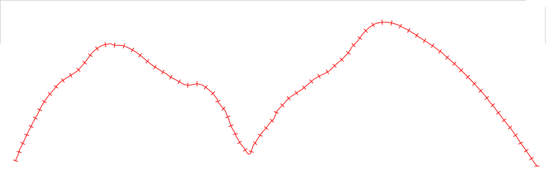

I have a curved line and because I wanted it to be divided in segments of equal distances, I used a Rule effect.
I divided that line in 80 segments, and as you sure know, those divisions are not nodes. You can see the line and its segments here:
How can I get the XY coordinates of all the segments where they cross the line?

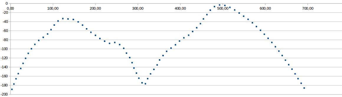

Tried my suggested method and it leads only to X coordinates right, not so sure why -probably because the coordinate system is flipped? Or some transformations caused by resizing the page? Who knows.

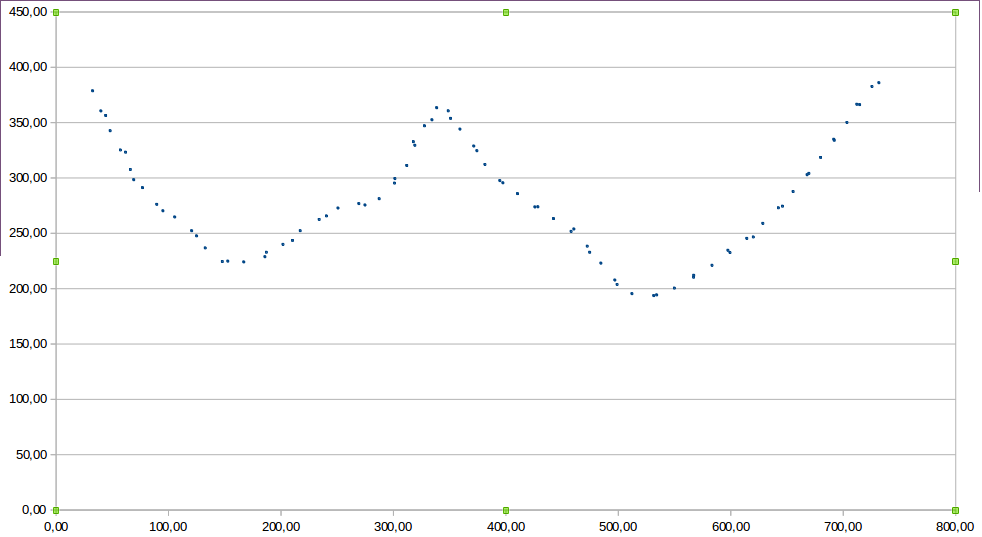

v1nce. Thanks for your answer. I copied/pasted all the code between <.html"inline-attachment">
- Pantallazo.png (18.67 KiB) Viewed 3751 times
