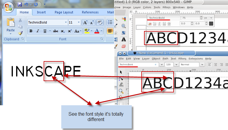

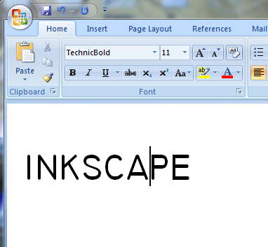

Re: Technicbold font
But in windows the font likes......Please see attachment.
- 3-17-2015 9-36-07 AM.png (35.79 KiB) Viewed 7962 times
Not sure that's Euro Technic Bold... That font is very different, rounded with different strokes.
I'd look for a similar font, designed as cross-platform ttf.
md1 wrote:But in windows the font likes......Please see attachment.
I think there is something wrong with the font, especially in linux.
Regardless, the font looks very different from your windows example.
Please look at closely.
- 3-17-2015 9-36-07 AM.png (189.29 KiB) Viewed 7799 times
