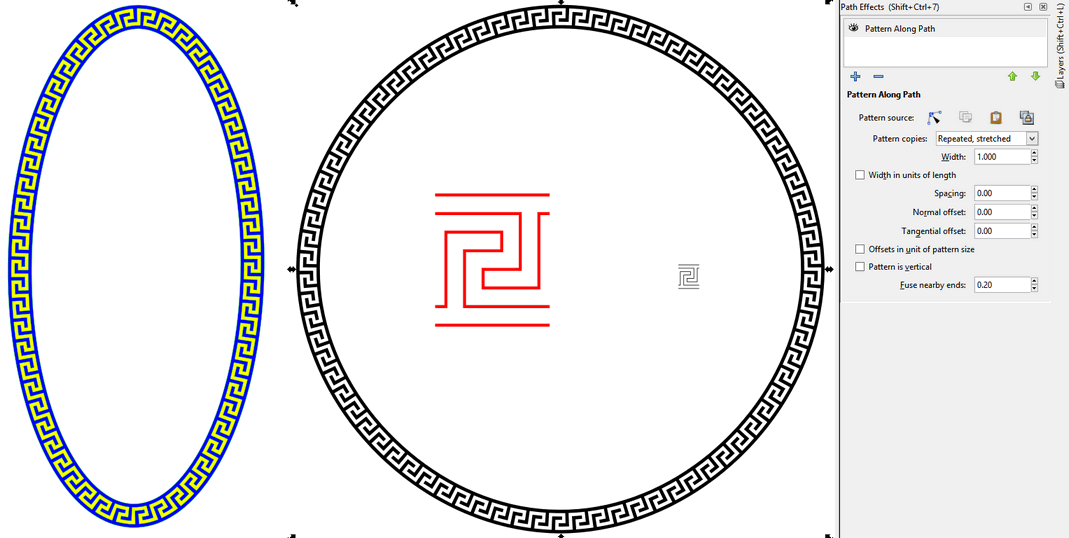

Made a simple grid with the transformation panel, then with the snapping enabled, traced one single pattern,
applied a spiro-path lpe, then duplicated and combined them together.
24 repeats fitted it better.

Wow! That's really good! I could follow that easily. Smart way of doing it!
I was making my own tutorial for the circular meander - reckon I can skip finishing it after seeing yours!
Thanks a lot for the great effort!
Lazur URH wrote:Here is a version with a bit more explanation, though parts of the basic useage -like the align and distribute panel's for correct spacing, and maybe some more- is not split to step by step.
Hope it can get things clearer:
meander svg
ragstian wrote:Hi.
I agree - very well done tutorial - might be a new way of doing things.
