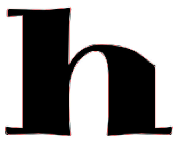

Gimp doesnt produce very acurate paths from selection, although that may not be a problem in this case.
I wonder why you not just export to bitmap and then trace in Inkscape....
- GimpPath.jpg (18.37 KiB) Viewed 8476 times
