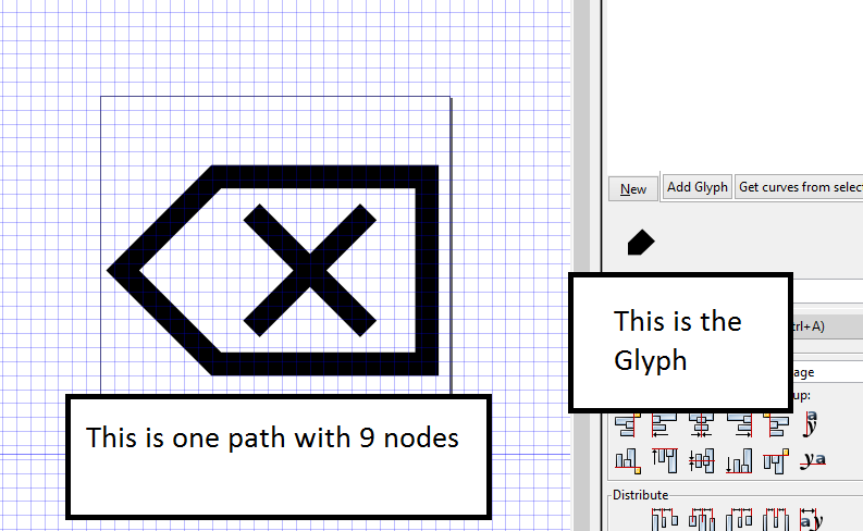

Thank you all for taking an interest in my problem. I tried all possibilities for path merging (combine, union, difference etc.). Combining works with the image since I get only one path and the image is still intact. But when I then add it as a Glyph (Text -> SVG Font Editor -> font 1 -> Get curves from selection) the glyph looks like a shadow of the image.
I will attach one of the problematic svgs and and image explaining my problem graphically.

- The problem
- glyph.png (34.54 KiB) Viewed 3508 times
Re: Converting path to SVG Font
Attached is backspace.svg where I used Stroke to Path. I didn't do it, but you'll probably want to Select All, then Path menu > Combine. If it becomes filled in with black, open Fill and Stroke dialog > Fill tab then click Even-Odd Fill Rule button (looks like a rounded heart shape with hole in the middle).

Thank you community, thank you brynn!
The Stroke to Path function did exactly what I needed. Afterwards I had to use Path -> Union instead of Path -> Combine and now all my glyphs look like I want them to look.
