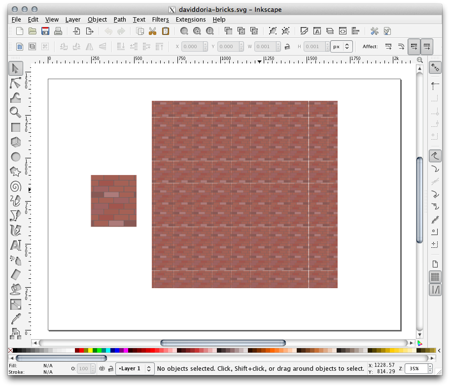

When I apply a custom texture to an object, there are dividing lines between where the texture is tiled. Here is a screenshot:
daviddoria.com/Uploads/bricks.jpg
(here is the original file: daviddoria.com/Uploads/bricks.svg )
The lines are visible when I export to a pdf as well. Strangely, when I view the SVG directly in chrome, the lines are not visible.
Is there anyway to make the lines disappear?

Hi David,
That's a known issue. In this topic is a link to an Inkscape filter which will help to obscure the lines viewtopic.php?f=5&t=9034&p=33279&hilit=stitch#p32882
It may be that Chrome currently has better support for displaying SVG than other browsers. But when I view the SVG with Firefox, I don't see the lines either. In any case, Inkscape's new renderer, due with version 0.49 should eliminate this problem.

daviddoria wrote:I compiled inkscape trunk, and the issue seems to still be there. Were you saying to just wait until the release of 4.9? Or is it actually still being worked on?
Did you actually run the correct binary (trunk, not current stable from the default location)? See attached screenshots - for me, current trunk does not render gaps between the tiles of a pattern fill.
Attached screenshots are done on OS X 10.7.2, using the provided example file - bricks.svg - at the same zoom level, without any edits to the file.
Original screenshot (Inkscape 0.48.2 on Windows): bricks.jpg
- Inkscape 0.48.2, file: bricks.svg (unedited)
- daivddoria-bricks-0.48.2-osx.png (126.87 KiB) Viewed 1832 times
- Inkscape 0.48+devel r11072, file: bricks.svg (unedited)
- daivddoria-bricks-trunk-r11072-osx.png (159.13 KiB) Viewed 1832 times

Ah, you're right. I actually didn't open the file in the new inkscape, but rather used a command line command to use the new inkscape to convert the file to a pdf (which is my actual use case).
I still see the lines in the output pdf with okular, but they are gone in Acrobat Reader. Very strange... but I guess it is not an inkscape problem anymore?

daviddoria wrote:I still see the lines in the output pdf with okular, but they are gone in Acrobat Reader. Very strange... but I guess it is not an inkscape problem anymore?
Probably an issue in (various) PDF viewers with pattern fills: in my quick tests
- Apple's Preview.app v5.5.1 renders it ok
- gv v3.7.3.90 (using Ghostscript 9.05) renders it ok
- Evince v2.30.3 doesn't render the pattern-filled object at all (malloc error)
- Xpdf v3.02pl5 renders with gaps between the pattern tiles
