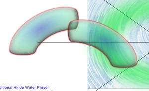

See attached pic. I have Inkscape latest version running on a dual core Win7 64 bit pc with 4gb ram. Inkscape is now running very slowly after I created a 2nd object using the EdgeEffect 3D extension. The 2nd object is just a copy of the first. The slowness started right after I copied the 1st object. Could the objects have too many nodes? File size is only 536kb.
Any way to fix this? Thanks!

Hhmmm, your system seems to have enough RAM to handle this, certainly enough for that size of file. That extension would not add any extra nodes. But filters are notorious for causing performance issues such as you're having. Do you have any other filters in that file?
There are some things you can do, to continue working on the file, with as few slowdowns as possible. (note to self: write tutorial). Divide the file into layers. Hide layers that you don't need at the moment. Zoom only as much as you need. The further in you zoom, the slower Inkscape can work. Use View menu > Display Mode > No Filters or Outline.

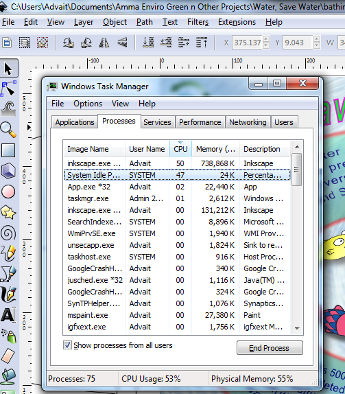

When I use the Edge3D effect, InkScape starts using about 50% PCU and about 788mb of ram! Wow! So obviously some kind of memory bug with Edge3D. I presume the developers are aware of this problem and will fix when they can. If this is a new problem, how should I submit a but report? If there's some other way around this problem with Edge3D, let me know.
See pic for a screenshot.
