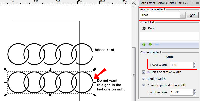

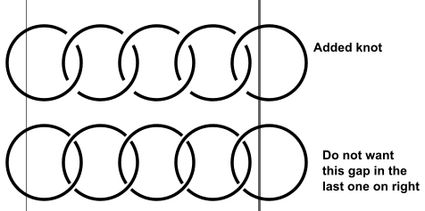

I drew a circle 10Px(did not use object to path) and duplicate 4 times. Then aligned them and Path/Combined and used Added Knot.
When I started Changed Fixed width I noticed the last circle got space on the right which created problem. Rest of the circles got proper spacing.
I wonder if I am making any mistake and how could I get rid of the right edge space in the fifth circle.
Please refer screen shot.
Thank you
Need help in adding knot

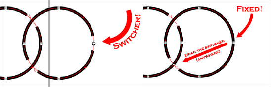

Abunai! Opening it in 48.3 gives me the same problem as you! - but daijoobu desu!There's an easy fix... Switch to the node tool
. as soon as you click on the path you will see the nodes of the original path(before the knot LPE) AND you will also see this little 'control' called the 'switcher'. If it's very small you can try setting the size larger in the path effects dialog (probably won't work)... Just drag the switcher to some other crossing point. it shouldn't be where it is, it's a bug that apparently is already fixed, just not in the current release.

Re: Need help in adding knot
nihon94 wrote:By the way what am I suppose to do with the switcher?
The switcher changes which segment of the 'knot' is drawn on top and which one goes on the bottom by dragging it to the intersection where you want the crossing to change and then clicking it. It should not be on a node, but at an intersection. Don't click it but drag it immediately... clicking is telling inkscape to do something impossible, changing the layering where there is nothing to layer. ...
Using the node-editing method means that all your knot crossings become immediately fixed, if that's OK with you...

Thank you for clarification. I was still playing with knots but sorry I can not proceed with switcher as you have explained because it never do anything except showing error message.
I have also followed your screen shot but nothing. I do not know if I re-install inkscape will it be helpful or not.
