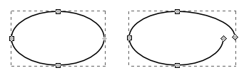

Here's what I mean
Re: trouble with nodes
johnnybgoode wrote:Here's what I mean
This is because when your drawing your ellipse, your actually drawing an arc (the ellipse is not closed). After you've drawn your ellipse, with
tool still selected, you'll see on the tool control bar three buttons that let you switch your shape between a segment, an arc, or a closed ellipse. Clicked the third one for closing the ellipse, and then when you convert it to a path you shouldn't have those two diamond nodes on the right. If the buttons are inactive it's because the shape is already closed.-
You're welcome. And also thanks to microUgly, who solved your original mystery.
A couple of tips. If you look at your last image (nodes.png) above, and the ellipse on the left -- notice the node on the right side, and see how it looks different from the others. That is always an indication that there is more than one node on the exact same position. You can't know how many until you start pulling them apart.
Or (and this is the other tip) you might not have to pull them apart to know how many. If you look at the bottom of the Inkscape window, and approximately in the middle, all kinds of wonderful status info is displayed at every step you make on the canvas. So if you select that same ellipse with the Selection tool, you would see that is has 5 nodes, rather than the 4 you expect. So you can conclude that there are 2 nodes on the right side. You can't always use this method (to count stacked-up nodes), because as you work with Inkscape, there are times when there might be several nodes stacked up, in several places along a path (Paint Bucket tool, for one example). But in this case, it works. However, it's the status/info area that I wanted to show you. It is an invaluable tool in both learning, and using Inkscape.
