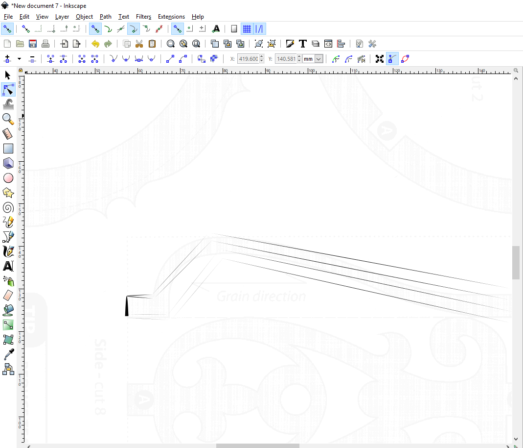

Thanks Tyler. I followed along exactly as your gif. I got two sort of gray ghost lines. When I roll over them, they turn red for an instant and then go back to gray. I'm not sure if I have a glitch in my software or what. How do you assign a color to the fill so the line shows green like yours?
Re: New user question re: break apart/ungroup
Assign another stroke color by shift-clicking on a color in the palette (at the bottom), or by choosing one in the second tab of the Object > Fill and Stroke dialog. The third tab allows to change the stroke thickness.
Thanks Moini, I did try that but I can't seem to make it work. I'll keep banging away at it and soone or later, I'll figure it out.
Can you share a file, octoolguy?
Moini, here is a screen shot of what I get when I do the trace. I have turned the opacity down to zero for the top layer.
- 2018-08-15_1543.png (164.93 KiB) Viewed 2445 times
