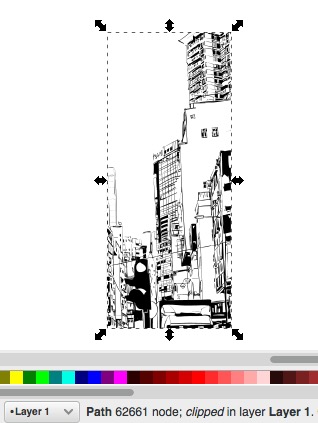

I have a path and a rectangle, and would like to do an intersection. When I select both objects and choose intersection, nothing is left. The same is true of any boolean operation on this path. Can you please help? Is something about the path causing this behavior?
The SVG can be found here:

(path is a street scene already missing some parts; rectangle is black in the upper right)

Q. Is something about the path causing this behavior?
A. 62761 nodes maybe
if you only want a small part of the picture just trace a cropped image instead of tracing the whole and trying to cut away parts.
Re: Objects disappear after boolean operation -- weird path?
Why not clip-it-away with the rectangle:
Works when you reverse the path direction of the street scene.
Sounds like a bug or inconsistency to me, because reversing the path of the rectangle should do as well - but don´t.
Polygon wrote:Why not clip-it-away with the rectangle:
