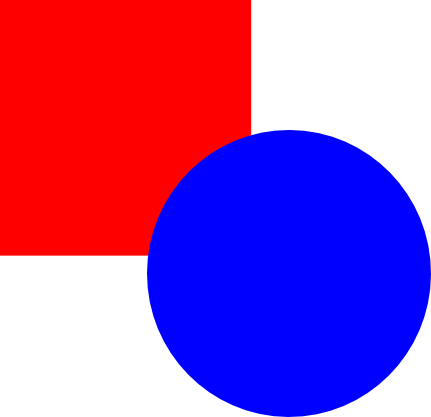

Anyways, none of the tactics you suggested has worked for me. I created a red square and a blue circle, grouped them, and saved it as an Inkscape svg. Then I saved it as a wmf. Only the red square shows up in the wmf.
Then I saved it as a png. No problems there. I opened the png and then saved it as a wmf. It gave some sort of an error message that I did not understand.
So, my question is, why have Inkscape given the option to save as wmf, when it clearly does not do the job?
I have attached the files for your perusal. For some reason, files with extension wmf will not attach to this forum. So, you'll have to take my word for it.
Any help will be appreciated, as MS Office 2003 does not import svgs.

Re: Cannot Export to WMF
I managed to solve this problem for myself:
I am using inkscape 0.48.1 with windows 7 64 bit ultimate.
I installed uniconverter from http://sk1project.org/modules.php?name=Products&product=uniconvertor&op=download
( uniconvertor-1.1.5-win32.msi )
and then copied two files :
C:\Program Files (x86)\sK1 Project\UniConvertor-1.1.5\inkscape-patches\uniconv_output.py
C:\Program Files (x86)\sK1 Project\UniConvertor-1.1.5\inkscape-patches\uniconv-ext.py
to C:\Program Files (x86)\Inkscape\share\extensions
overwriting the existing files.
Save As wmf now works.
Thanks Matt.
Thanks Matt.

BazzaBoy wrote:I created a red square and a blue circle, grouped them, and saved it as an Inkscape svg. Then I saved it as a wmf. Only the red square shows up in the wmf.
I think that's a known bug, but not positive. It sounds like one, anyway.
BazzaBoy wrote:It gave some sort of an error message that I did not understand.
Was this using Inkscape? Could you please tell us the error message? Would you be able to try converting PNG to WMF with any other program?
