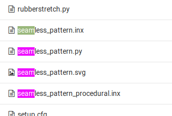

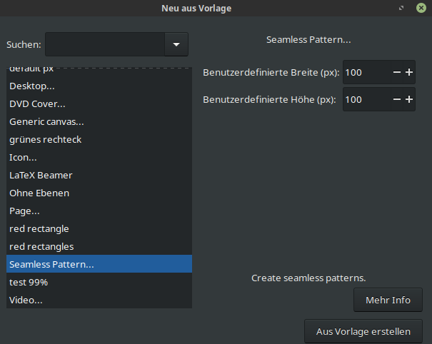

I just checked, it's not a custom template. And it is included in master, through extensions:
https://gitlab.com/inkscape/extensions
- Bildschirmfoto_2019-04-28_16-24-08.png (12.37 KiB) Viewed 2312 times
- Bildschirmfoto_2019-04-28_16-22-26.png (35.11 KiB) Viewed 2312 times

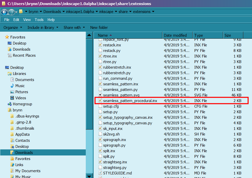

Brynn, can you search in your Inkscape master program files to see if there is a seamless_pattern_procedural.inx file?
Re: Seamless Pattern On Inkscape 1.0 Alpha
Yes, there is.

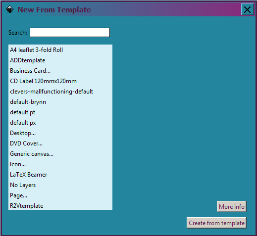

Brynn: and yet it does not appear in the New > From Template dialog?

Moini, that's correct, no template. See screenshots.
- nt2.png (116.85 KiB) Viewed 2215 times
- nt.png (14.38 KiB) Viewed 2215 times

There should also be one labelled 'Video...', at the bottom - maybe it's only the scroll bar that is missing?
Yes, I submitted a bug report about the missing scrollbars and other visual oddities about this version. Fortunately, I can scroll with my mouse. Let's see....
Oh yeah, you're absolutely right. Seamless Patterns template is there. You just need a scrollbar to have a clue!
Note that the missing scrollbars and 3d effects only happen when you use the win32 theme. The system theme does have scrollbars.
