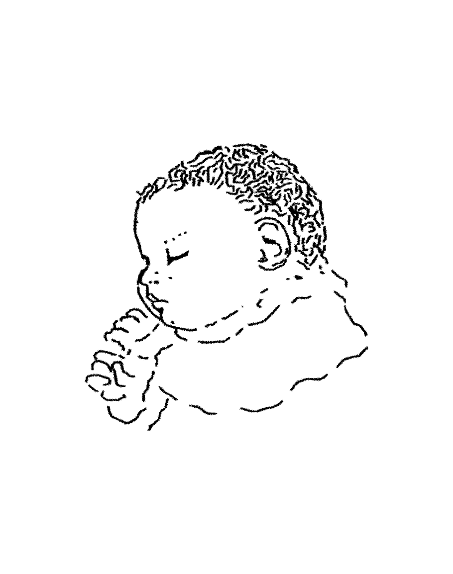

Hi there I have searched and come up with several examples of what Im looking to do but I just cant seem to figure out why i can not get it to work.
I have an old hand drawn image of my daughter that I created years ago for part of our logo. The original is long gone and all I have now is a scanned in image of a photo copy.
I took this and traced over it with just the pencil tool and have got an image I am mostly happy with but I would really like to make the lines a little less pure solid and look more textured like a real pen or pencil. I saw the post on the signature and the answer was simply to add a filter i believe it was distort-chalk/sponge. I cannot get this to work on the full image or even on a single stroke of the pencil separate from the image. When I apply the filter or any for that matter to the pen stroke it massively distorts the stroke or in some cases it disappears from the selection box altogether (the box around the selected pen stroke)
How I made the original stroke was just a simple black line adjusted the width selected it then double clicked on the pencil tool and chose take from selection. The line width is 2.034 no fill just stroke. When I apply the chalk/sponge filter it blows the line up. I will try to add an attachment of the drawing and the line before and after. The blue area is showing the selected line to the left after the chalk/sponge filter was added. I changed the color to white to show better but that is it. As you can see it increased the size and completely blew it up.
Thank you for any help and guidance.
I am not sure how to attache the image. Which file format is the best to save it in. I used png and pdf and both were distorted. svg is too large
realistic pen pencil chalk line help

Thank you. I was thinking the same thing about the width of the lines and I believe you are absolutely correct.
Part of this conversion is motivated by the need for scaelability the small original logo actually has achieved a very nice "vintage" feel to it that goes well with our Old World theme being but. The need to scale it up is for say a banner or large print it kinda works but its rather furry. I though if I re do the whole thing correctly I would not need to worry about any size in future projects.
I'm not sure what is taking up so much space the image right now consists solely of just pencil lines and its at 470 MB. I also used the clean up document feature after reading a bit on it. The original has been deleted. I took a screen shot and will attach it here. It looks like i need to download gimp to do this properly.
Thank you again.
Thank you again.
- logo drawing example.png (90.5 KiB) Viewed 2641 times

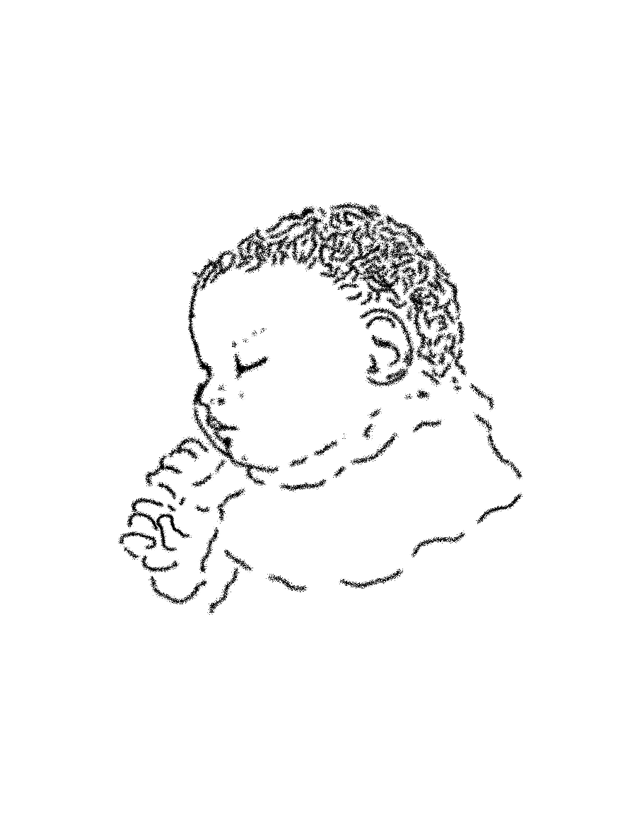

Just for fun here are four versions from your target. Note that the biggest file (babyface3) was ONLY 264KB, which was too large for this forum so I compressed it.
- babyface3.svgz
- (124.5 KiB) Downloaded 80 times
- babyface3.png (222 KiB) Viewed 2609 times
- babyface4.png (162.38 KiB) Viewed 2609 times
- babyface2.png (145.01 KiB) Viewed 2609 times
- babyface1.png (145.29 KiB) Viewed 2609 times

Honestly speaking the stroke of a pencil look rather different than what's depicted on your drawing.
What we see is looking more like a line drawing -drawn with a much wider "instrument". Contrary a pencil drawing of those traces would look very light and most likely wouldn't give the intended visual impact.
Simply put: the original drawing doesn't work well with a pencil-like texture because those strokes are too thick and tapered by a different logic.
On the other hand the drawing style is more suitable for a linocut or a drybrush.
Re: realistic pen pencil chalk line help
Attaching example svg -handle with care, resource, rendering may appear *resource heavy*-.
Screenshot at 266% zooming:
