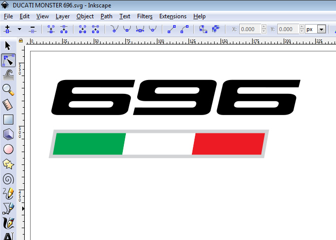

very new to Inkscape, so apologies in advance for being technically inaccurate. I'm trying to upload an SVG to Cricut Design Space, and there's something I'm missing about the color of an object/path in Inkscape. In the attached SVG - which I found on the web an edited to my needs - the number "696" is filled in black:

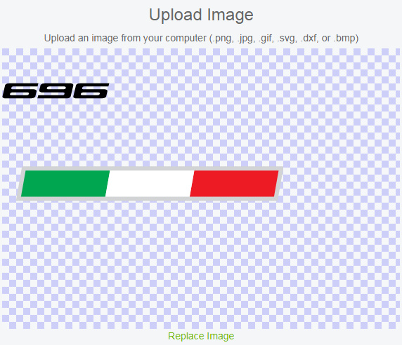

If I upload the file to Cricut, to my surprise, I get this:
The only way to get the "696" to correctly show up on Cricut is to use the Fill bucket tool, and manually click on each digit of "696". This - I noticed - doesn't actually change the fill color, but rather creates a duplicate of each digit. What are these new entities, and why does a "fill" create a new object, to begin with? Why is the original "696" not rendering properly in Cricut, when the duplicates do?

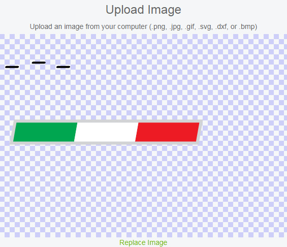

Thanks for responding, although converting the objects to paths did not make any difference (I'm pretty sure I've tried that already, but I did it again just in case). I was puzzled by the fact that the only portion of the "696" that was showing up in Cricut (in black) were the little eyelets (white!) of the 3 digits. I used the Path > Break Apart function, which caused the eyelets to become separate paths, brought them in the foreground, then for each digit + eyelet I did a Path - Difference, which basically re-cut the eyelets on the digits. Everything looks absolutely identical in Inkspace, but now Cricut sees the "696" as it should, sizing aside:
