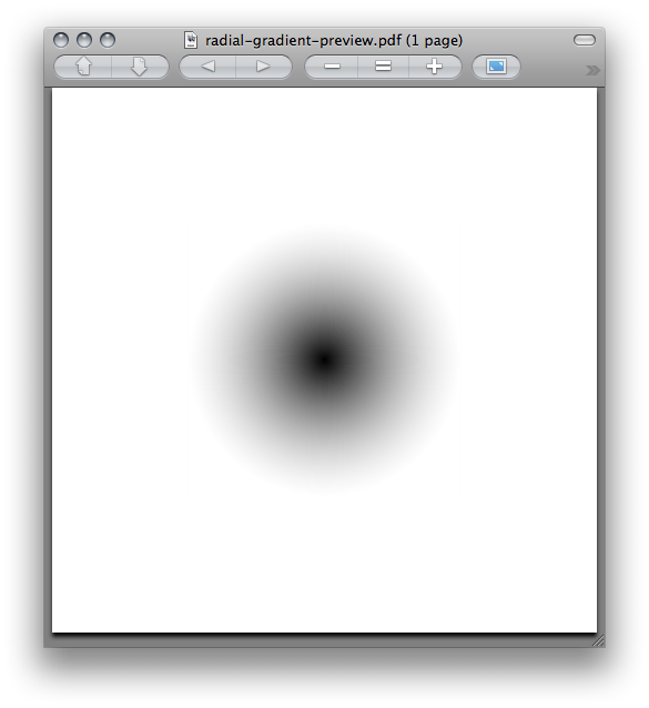

Apparently I missed this line when writing my earlier reply. Sorry. I assume that the radial gradient goes from fully opaque in the center to fully transparent at the outer gradient stop.guus wrote:I simply created a rectangle and set the fill to a radial gradient, and then exported as pdf.
Maybe you could attached such a PDF file generated with Inkscape on Lion? Or did you already try yourself whether the same PDF file views as expected if transferred to a Leopard Mac and viewed with Leopard's Preview.app? (I doubt though that the same Inkscape binary would create different PDF output on OS X Lion and older versions of Mac OS X).
Attached PDF was created with Inkscape 0.48.2 on Mac OS X 10.5.8 Leopard and views ok in Preview on Leopard. Could you test it in Preview on Lion?
- radial-gradient-preview-pdf-screenshot.png (79.43 KiB) Viewed 3348 times
- radial-gradient-preview.pdf
- (2.78 KiB) Downloaded 180 times

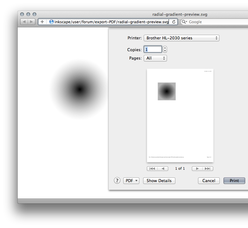

Handling of radial gradients seems to be an issue elsewhere on Lion (in Apple software): see the attached screenshot of Safari 5.1.2 (7534.52.7) on OS X Lion, showing the (PDF-based) print preview for the same SVG file used to generate the PDF file as seen in the screenshot of Preview.app (attached to my earlier comment):
- radial-gradient-preview-SVG-Safari-print.png (96.52 KiB) Viewed 3093 times
