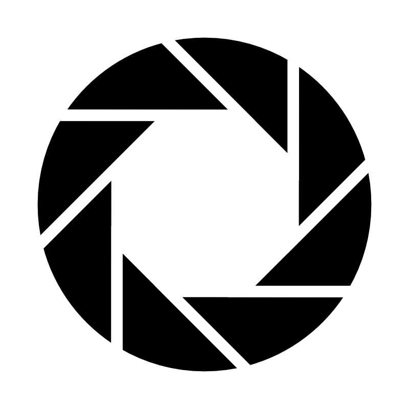

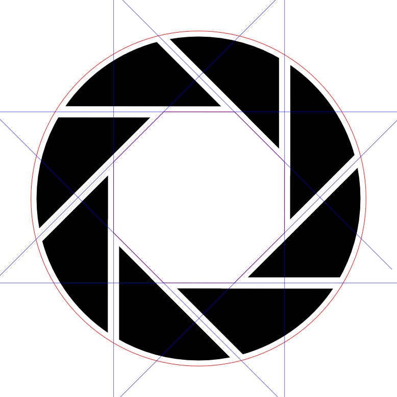

i did it obviously....but i was wondering, how would you all do it ?
especially if you want every black shape to be a shape of it own (no "cheating" with a white stroke as i did)

There are many many ways.
Like you can draw the black shape as an ellipse, align a 8 pointed star over it, set it right with the handles, add a thicker stroke, convert the stroke to path, subtract it from the circle and break it apart.
Or use a poligon with 8 nodes only, convert it to path and use the node editor tool
to change nodes to smooth ones, break apart the path at each segment by duplicating the nodes,
connect unconnected segments here and there, ann new nodes, move them around, and add a white stroke at the end.
Personally I'm more into an accurate design with right proportions.
Thus likely I would use spiro-path effect to add right curves to segments at the outside, just as in that meander.
Would need some time to describe how I would draw it exactly, and the method would look a mess.
Will try it later on anyway.

Certainly I'm not writing the most trivial solutions, just to come up with different approaches.
Attached is step by step illustrations of the first two, though they are relatively fast, the result is not so accurate.

I had some time, so I put together a quick tutorial. Not gorgeous, but it's 1 way to do this. I call it a fan icon, because it looks sort of like one of those giant exhaust fans....or maybe the fan that's in front of a car's radiator.
I didn't quite follow what Lazur is doing in his file. So hopefully I'm not reiterating what he said. But I will repeat this -- there are a number of ways this could be approached. Maybe others will share some different ideas?
If anyone sees any errors, let me know, and I'll fix it

My first suggestion took the exact same direction, thank's for making a clearer guide!
It's more of a shutter, isn't it?
Anyway, attached is an svg with two more accurate methods,
with a bit of explanation.
May answer what is the real problem by the accuracy, though for an icon it really doesn't matter that much.

Here's a different way than suggested above, not as precise but more fun perhaps.

druban wrote:Here's a different way than suggested above, not as precise but more fun perhaps.
this is a very intuitive technique ! nice
Re: How would you create this logo ?
Well, you have the strokes ready there ---> Select the paths, then Path > Stroke to Path, combine them (CTRL and +), then subtract them from the ellipse (select both paths and hit CTRL and -). ^.^
