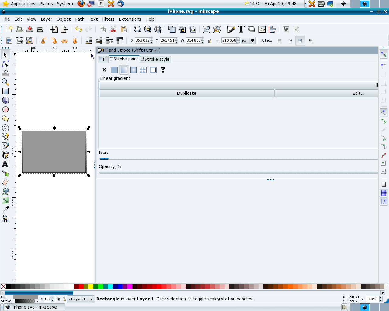

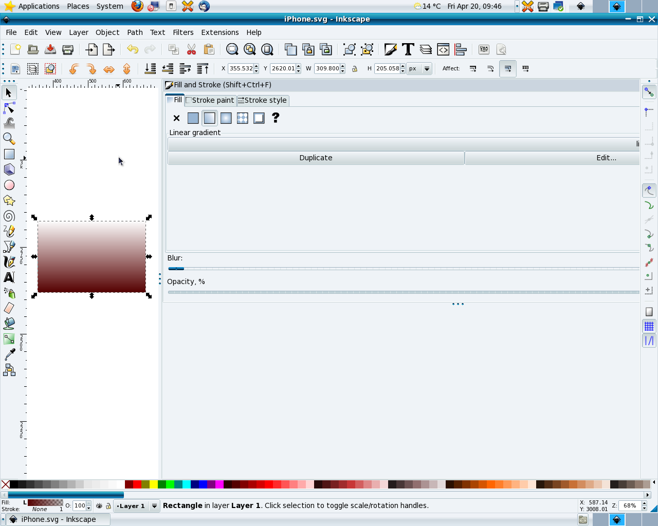

There are the images. It seem it happen with the gradient on stroke too. I believe the window is docked (?).
Yes, i reported it as a bug. I did this time ago and they answer me so i wasn't sure someone have seen it this time.
My screen resolution is 1280x1024, the same in the pictures.
And is Inkscape 0.48, not a dev version.
I also tested on another PC with Linux Mandriva and a Windows Vista and cannot repeat this. I had this problem for a long time, i thought when upgrade it a 0.48 will fix it, but didn't. Maybe is from the Pc, if i find any clue i'll tell you.

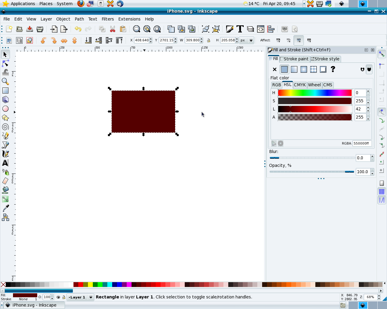

- Gradient on stroke
- gradient_on_stroke.png (129.05 KiB) Viewed 4549 times
- With gradient
- with_gradient.png (128.15 KiB) Viewed 4549 times
- Normal behavior
- normal_behavior.png (136.54 KiB) Viewed 4549 times

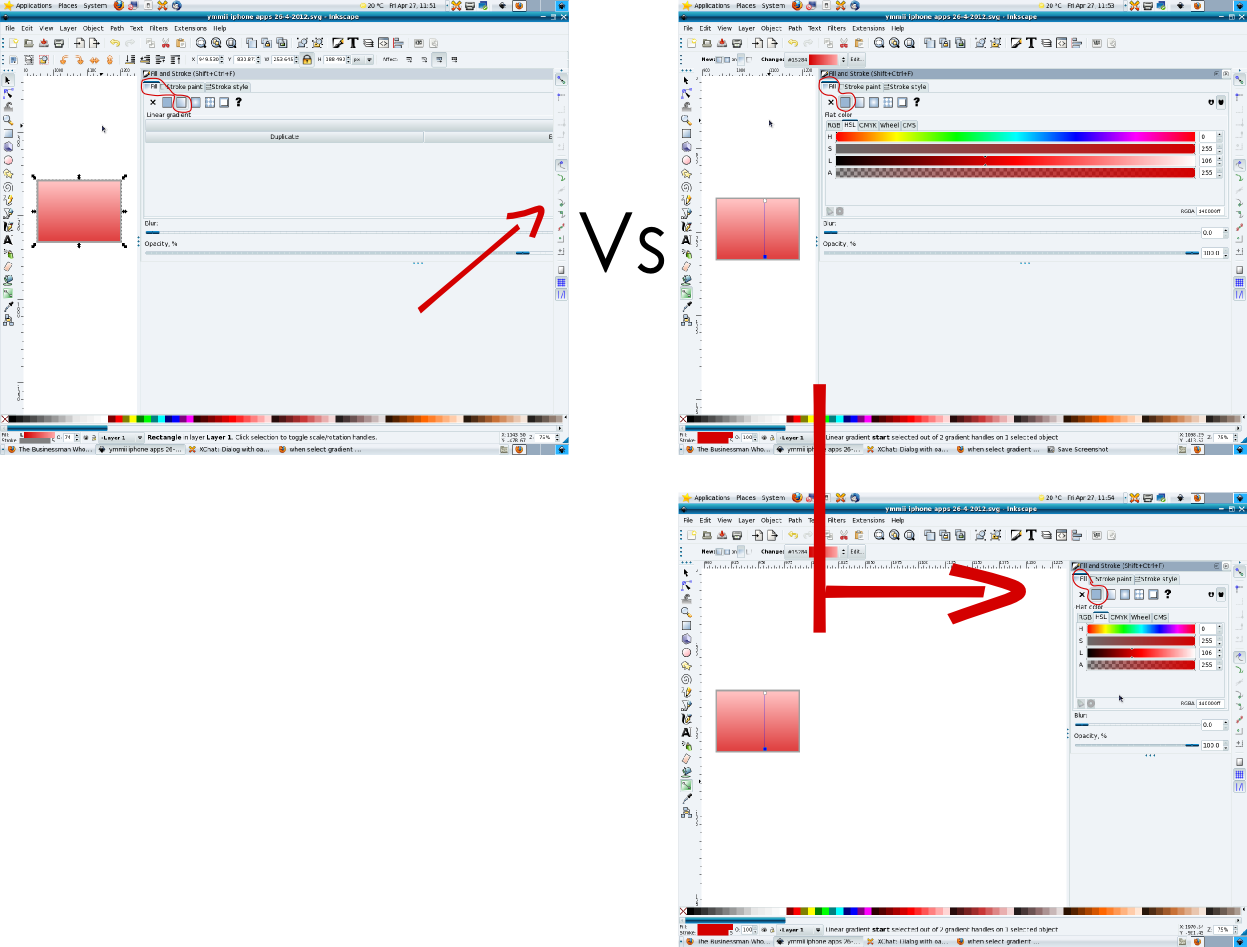

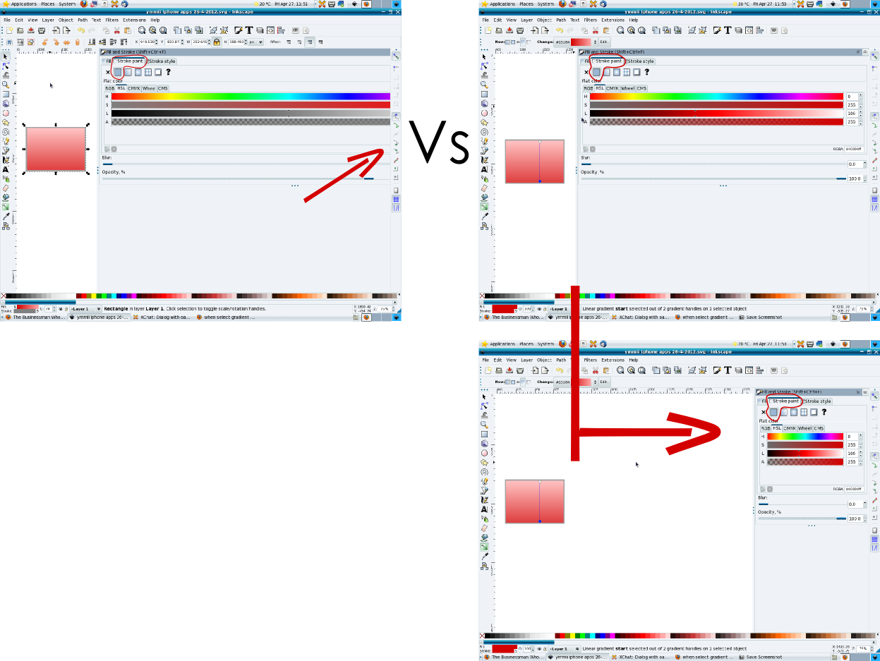

In the situation in your image the gradient vertex is selected so you can edit the color. In this case i can also drag the Fill and Stroke window. But when just select the object, it's locked in that position.
I will upload 2 images with the situation compared. Please pay attention to the red markers so you know the settings when this issue happen.
You can see there that when i select one of the gradient vertex i can drag the window, but when i select the object, the Fill and Stroke window is locked in both Fill tab and Stroke tab.
What bother me more is not that i cannot edit a gradient on an object without selecting the gradient vertex. I usually do it selecting the vertexes, it's better. But when i try to see or edit the color of the stroke on a gradient object: (step 1.) i have to create another object (step 2.) pick the color with the drop tool from the stroke and (step 3.) only then i can see the color code of my stroke, and that's kind of crazy. Is pointed in the images that i cannot see the right side of the image so i can see all the fill and stroke window with the entire color palette and color codes.
I'm not sure if you really get all that i write.
- image 2.png (197.43 KiB) Viewed 4466 times
- image 1.png (198.28 KiB) Viewed 4466 times
