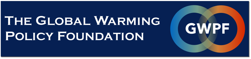

The background displays, the text displays, ... but the circles-with-gradients won't display (in a browser).
I'm sure this problem is exactly as simple as my last one turned out to be (thanks again, Lazur), but again, I'm completely stumped - and disappointed, 'cos it took ages tweaking those wretched gradients to get 'em right. Bah.
File attached.

looks ok to me? did you try closing and reopening Inkscape?
Re: Gradient won't display
The rings (which are masked objects) don't appear for me in either Firefox or Chrome. It might be a bug in the browsers (though it seems unlikely that it should be in both), as the SVG generally looks okay to me.
But a better solution for this would be to throw away the mask entirely, and just adjust the alpha value of the stops on the original colour gradient. That works in the browsers, and requires them to do less processing as well.
Xav, I'm in your debt. As you say, tossing the masks and setting the alpha values directly worked like a charm.
Feeling a tad stoopid now for having bothered with a mask in the first place - you learn s'thing new every day.
Thank you.
