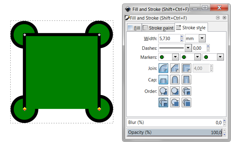

There are six buttons that control the order of Fill, Stroke and Marker.
I use the first button: looks like a regular stroke but says Fill On Top....
I use the second button....Stroke On Top, but Stroke is cut in half ???

Okay, it becomes a bit clearer once you add Markers....
- Marker Order.png (47.05 KiB) Viewed 1437 times
