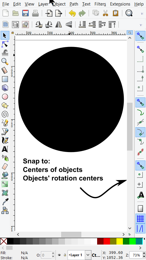

I lcan not do the first part. "Handle to object rotation centre".

Re: Make the highlight on a shirt button
^ It`s an option from the Snap toolbar
Maestral wrote:^ It`s an option from the Snap toolbar
Oh great, I thought it was an option there. I don't think I have covered those in the tutes yet.
