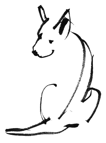

A couple questions. I tried a file that looks like the following, and it worked very well. The file on the left is the original, and the Centerline Trace extension did a perfect job:
https://www.screencast.com/t/4bLiJg8GbMJ
So then I try a simple sketch of a dog, more realistic to have lines that vary in thickness, and here is the result:
https://www.screencast.com/t/zx4g5y9R0X
Somewhat comical. So am I dealing with an extension is nowhere near capable of doing because the very simple first sketch?
I have attached the image... would so much appreciate if you would try on yours Brynn, or anybody else that uses this extension. I also attached the first one.
Here are the settings I have used, but I have tried many settings:
https://www.screencast.com/t/5THqtm5lo1s
Feedback appreciated!

Re: Thicker Lines On Trace Bitmap
Sorry I wasn't here today. I'm on Windows 7 64-bit and using Inkscape 0.92.3. I don't think you need to install all that extra stuff which is outlined in the PDF file. Just use these: https://inkscape.org/learn/faq/#how-ins ... n-sets-etc or the instructions on this page: https://forum.inkscapecommunity.com/index.php.
Yes, I get the exact same result as you do, with the sketch-like dog image. The problem is that apparently the centerline trace extension is having a hard time identifying a center line. I'm not sure if it's the non-smooth outer edges, or the variation of multiple shades of gray (like in the spine of the dog).
You could try processing the sketch-like image with a raster editor, and make it solid black. That would at least give us a clue if the shades of gray are part of the problem. Actually, I think I might know how to do that, so I'll try it, and be right back.
Yes, that gave a much more expected result. Not perfect by any means, but close enough that you could fix the problems relatively quickly.
I should note that the centerline trace engine is not designed to work with sketches, and that's probably why you see the weird results. I was only guessing that it might work. But at least now you know you can make that type of image a solid color, and you'll get better results.
Or if you want a variable width line, for example, where the sketch is lightest it would have the thinnest line and darkest would have the widest lines, you might want to hand trace and use the Powerstroke LPE (which is applied automatically with Pen or Pencil tool in Triangle In or Triangle Out shapes). You'd still have to tweak the lines after you draw them, but that sounds like a much nicer result to me.
Oops, just re-read your original message. I don't think the variable width lines would work with videoscribe. I don't know for sure though.
