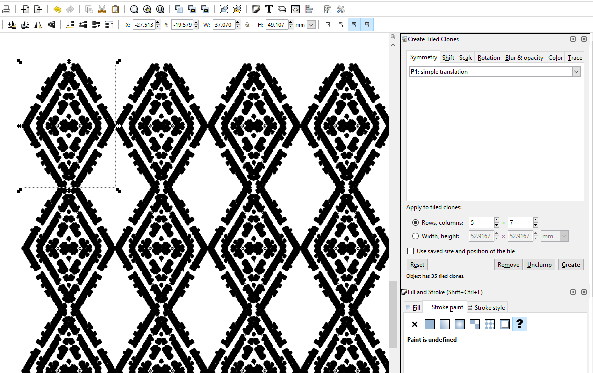

Hi, I'm having trouble with tiled clones. I've made plenty of them before, but with my current image, it's messing up.
I traced a design, then tried to do Tiled Clones, but the tiles look like they have a wide stroke outline on them, instead of looking like the original design.
I tried clicking the "reset" button in the Tiled Clones options. Checked the clone options. I don't see anything out of the ordinary.
Is this a bug? Or is there a setting I missed?
Pattern bug? Path looks like it has a stroke when tiled.

- Tiled clones of traced image
- diamond-pattern-tiled-clones-with-settings.png (213.33 KiB) Viewed 1504 times

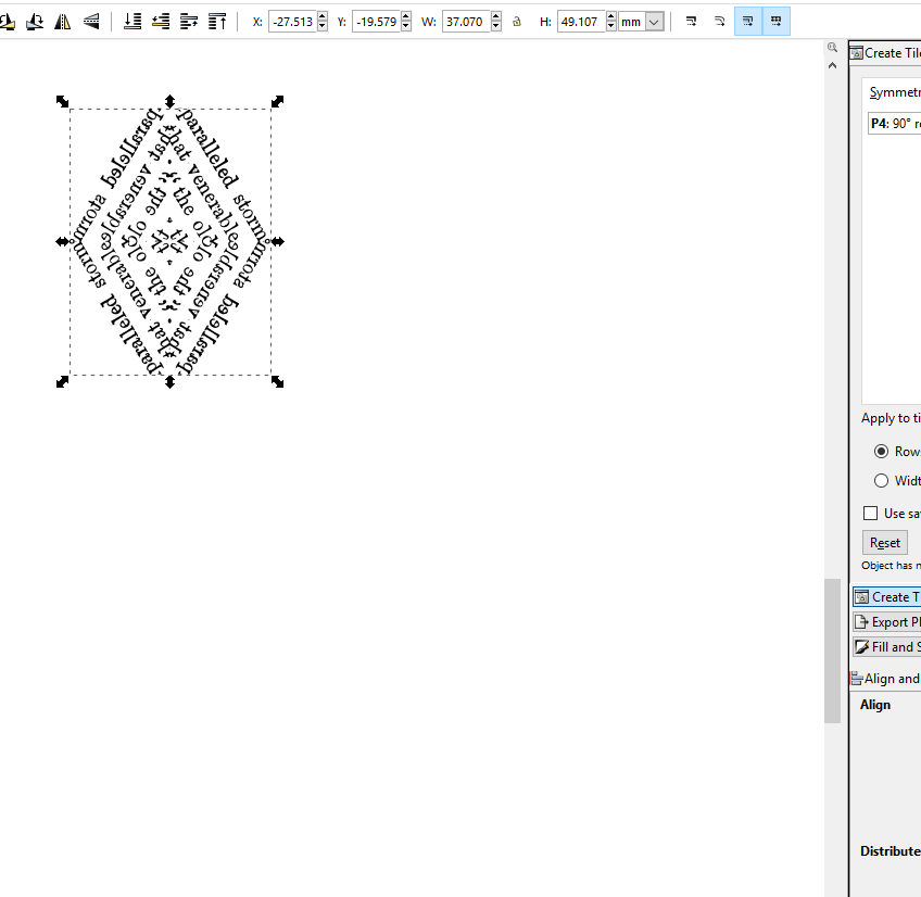

- Traced image
- diamond-pattern-single-diamond.png (57.3 KiB) Viewed 1504 times
Re: Pattern bug? Path looks like it has a stroke when tiled.
It's hard (at least for me) to guess from the screenshots. Can you share a file?
If the stroke was *unset* on the parent object, the clones can have an independent stroke attribute -a different width than the original.
Setting a black stroke on the parent object should solve the problem.
I guess it was that "invisible" stroke that I've had trouble with on other objects. So now I turned on the stroke, set it to black, 0 mm, then turned OFF the stroke again, and the pattern works great!
Thank you SO much for your help! <3
