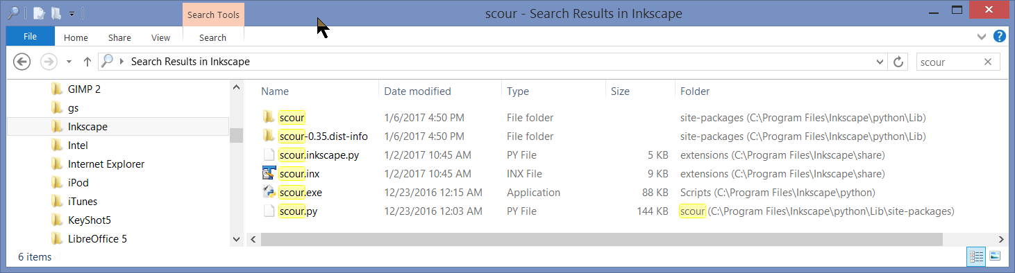

Does a search of your Inkscape directory look like this:
- scour_-_Search_Results_in_Inkscape_2017-02-05_15-50-37.png (58.04 KiB) Viewed 3212 times

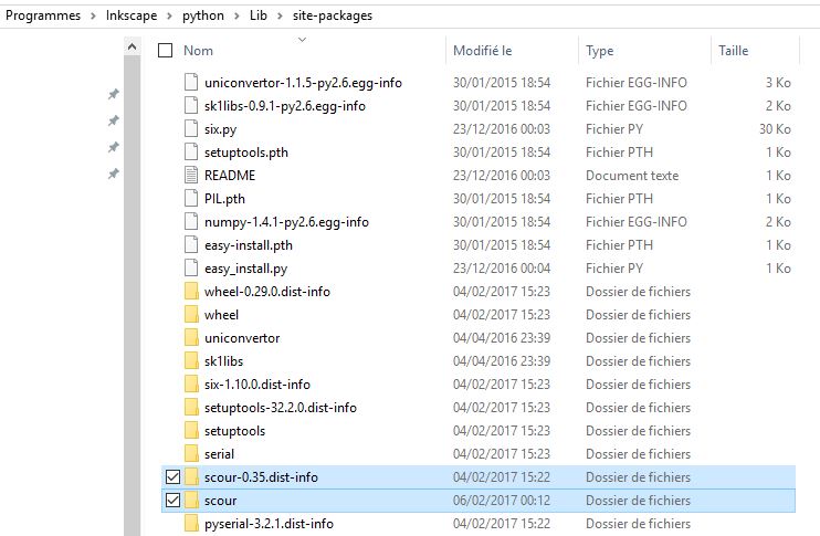

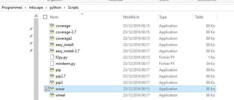

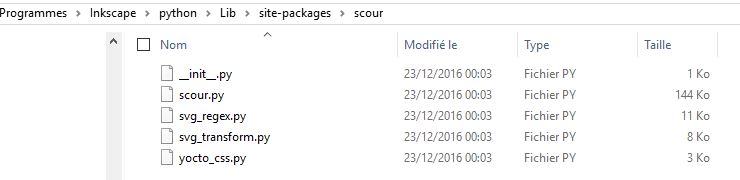

Re: optimized save with scour
Scour in the Inkscape directory looks like this:
Inkscape / python / lib / site-packages / ...
Inkscape / python / scripts / scour.exe
Thanks A+
Thanks A+
