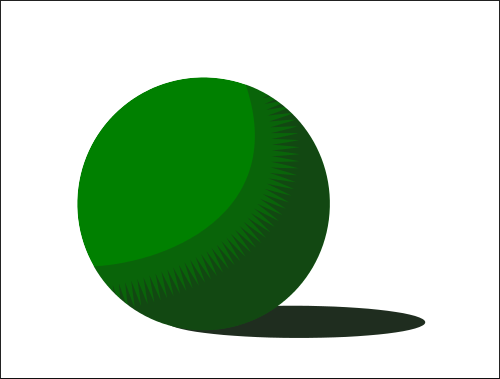

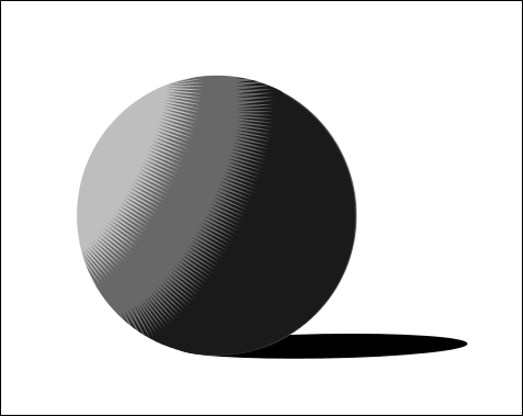

Ive also seen this kind of effect a lot in vector illustration (quick mockup):
EDIT:
added a slightly better version (i suck at 3D)
EDIT:
- Shading.png (19.49 KiB) Viewed 5844 times
- rect4438.png (39.65 KiB) Viewed 5844 times

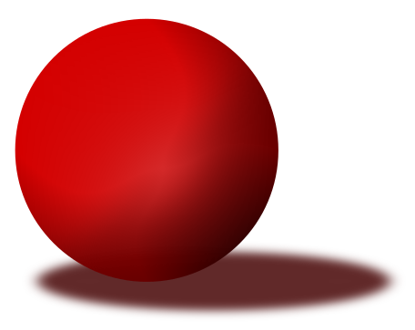

Then take a "damn" radial gradient:

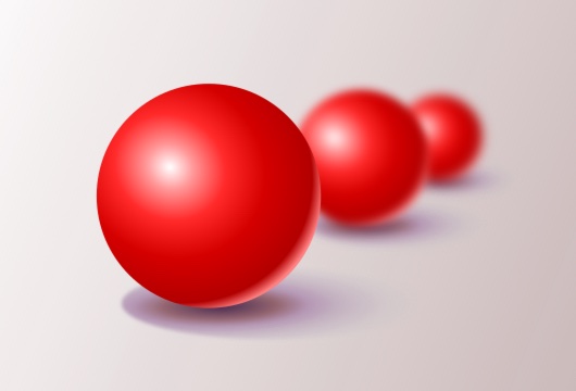

Fairly new to Inkscape. Was there a tutorial on impressive gradients like this ?
Re: Blending colors in Inkscape?
You could use a simple radial gradient to make the ball or marble, like in this msg viewtopic.php?p=97134#p88871. We do have the new Gradient Mesh tool now, but I haven't seen any tutorials yet.
