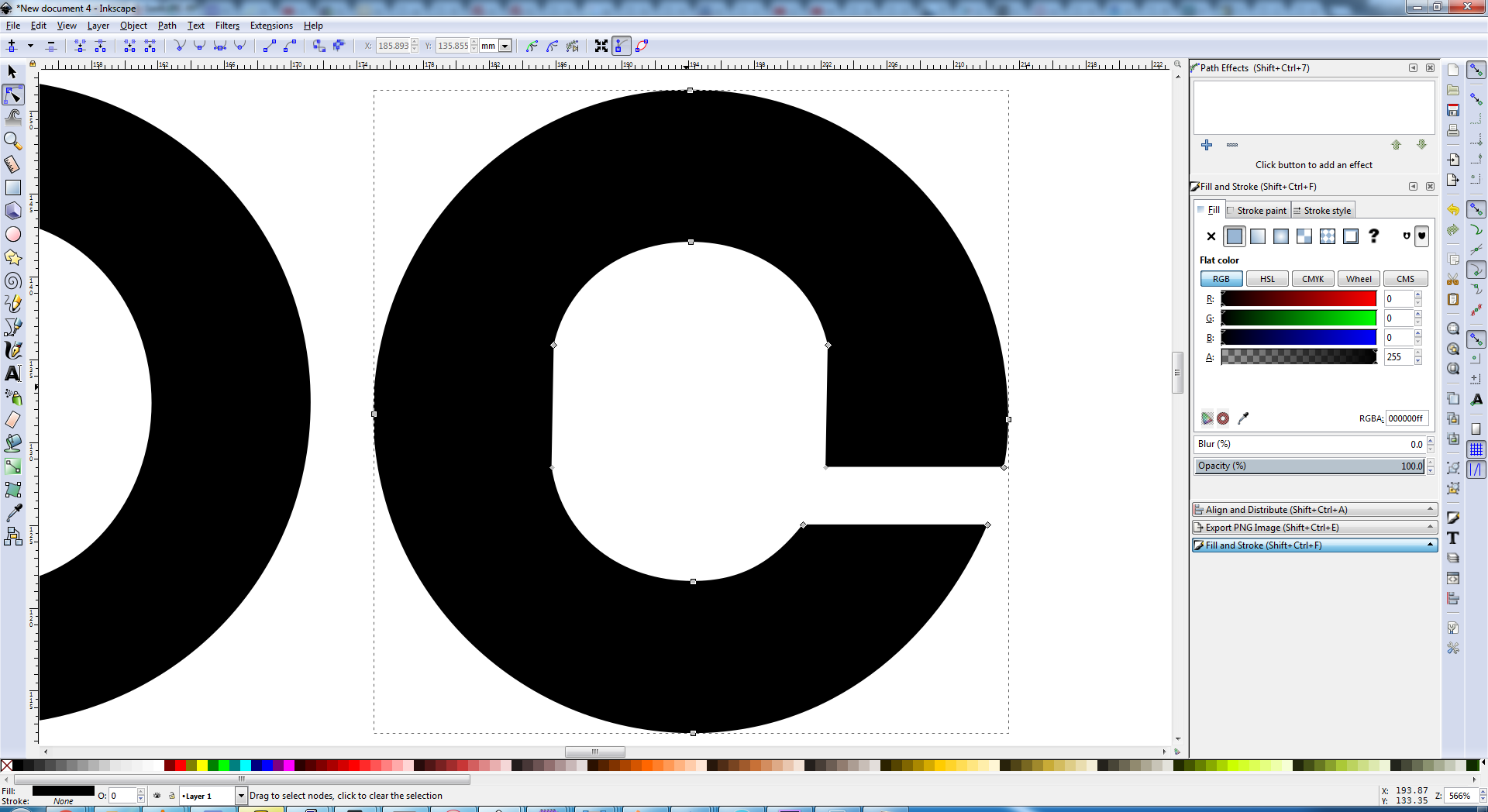

Clueless newbie here...sorry if this is an obvious answer. I'm trying to modify some pathified text so that I can replace the middle line in the "e" with clock hands, but I can't seem to figure out any way to "fill in", so to speak, the missing area of the outside curve where the line would normally intersect. This is as far as I've gotten...

1. draw two rectangles for your clock hands, such that they overlap with your "e"
2. select all 3 objects
3. Menubar | Path | Union
Done!
Done!

That sounds perfect, but for one thing...I need the left side of the e to sort of "extrapolate" the curve that would be there without the intersecting line. If only there were a way to specify the bezier's values manually, instead of by dragging...

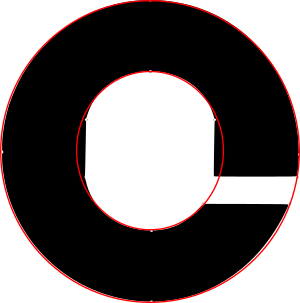

The outline and the inner border of your "e" are not circles but close to some ellipses, as indicated below by the red approximated ellipses. But these two ellipses do not even have the same aspect ratio. Well, that's how the "e" of this font was made.
I just can guess that you probably want to have the inner border in a "similar" curvature like the outer, i.e. deleting the straight vertical parts? Is it that what you meant with "mirroring"?
One way to achieve that could be:
1. draw and fit an "inner" ellipse
2. select your "e" and the ellipse
3. Menubar | Path | Difference
Done!
Done!
