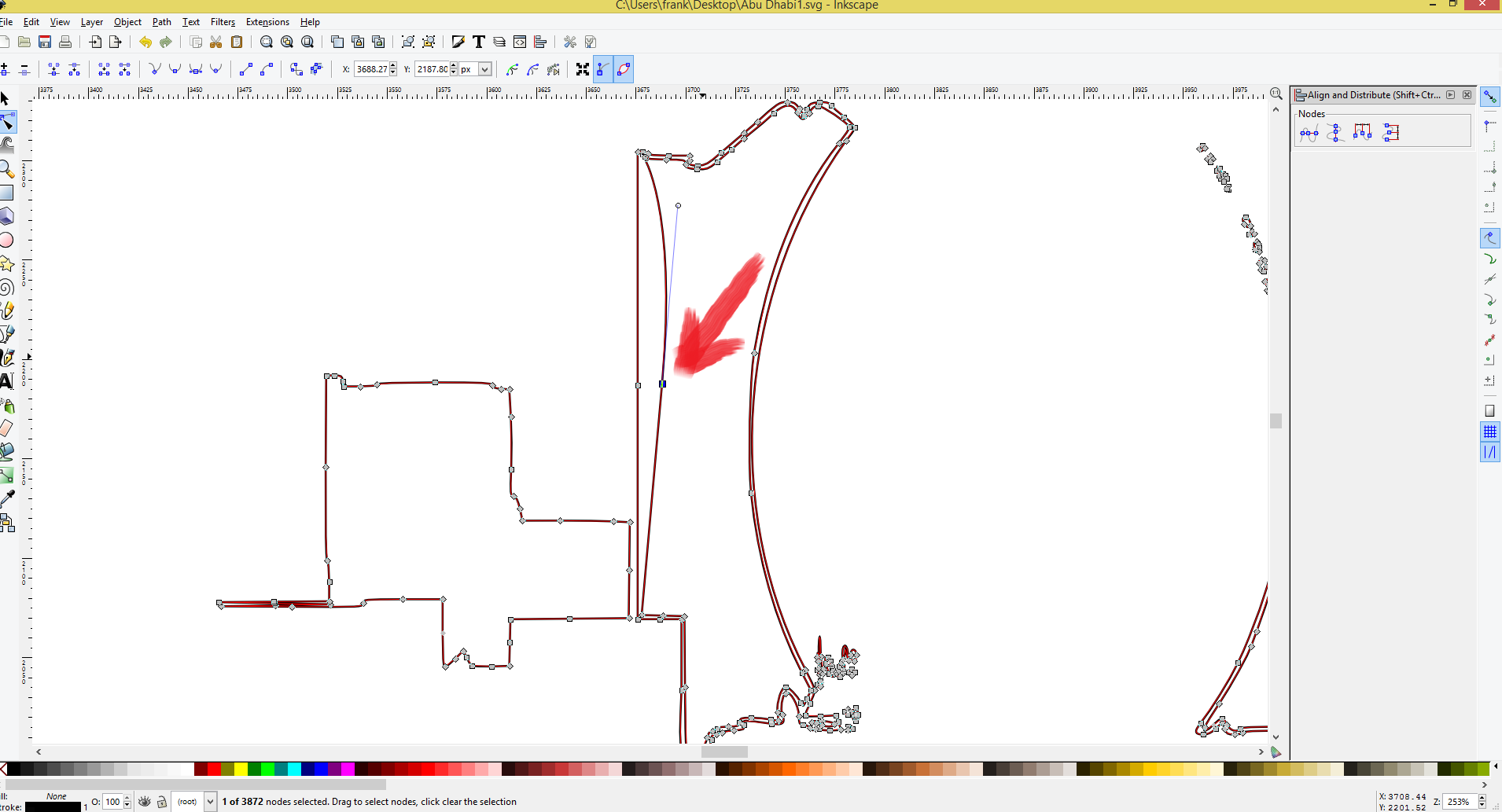

how can I extend the selection of nodes ..I want to remove a whole bunch of nodes who are connected to eachother..... by starting with one...
tried ctrl+ but doesn t work...
i am doing it 2 by 2 but it takes eternity for removing all the desired ones...
thanks in advance

A possible solution:
move the node tools cursor over a node,
then hold Ctrl and scroll with the mouse wheel.
Another one:
Break path apart (Ctrl+Shift+K), change back to object mode (likely by pressing Space),
Shift+Click the subpath you want to delete,
combine paths back together (Ctrl+K), and delete unnecessary object.
