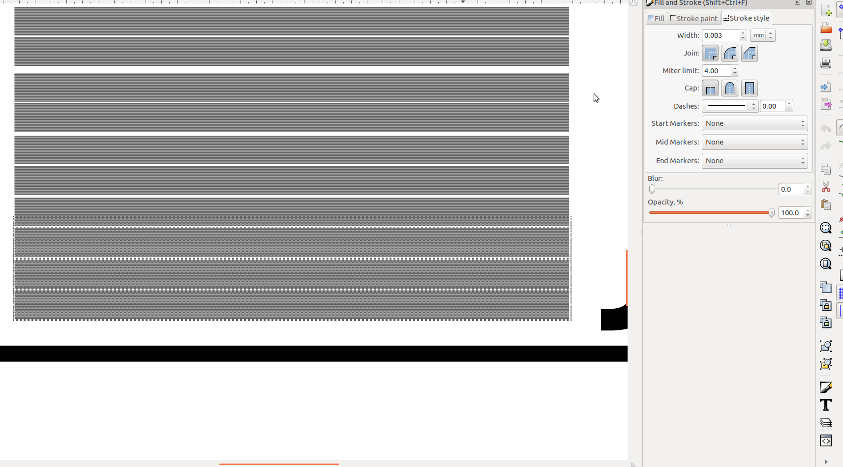

My SVG file consists of parallel (and perpendicular lines) that need to be printed at very high resolution (~25400 DPI). When I look at the lines in inkscape, they are the correct size and pure black & white. However, when I export the file as a PNG and look at them with gimp, they have some grayscale beveling added (beveledlines.png).
I have also attached the screen that I see when I highlight some of the lines in inkscape. The lines are intended to be 0.003 mm wide and the same distance away from each other. When I use inkscape to zoom into them, they are perfectly black & white, the right size and spaced correctly (inkscape_screen.png).

Make a pixel grid and see if your lines are actually aligned to this grid when zoomed in. Don't try to set the printing DPI in Inkscape. Do it in the GIMP. Leave the inkscape DPI at 90 and set the canvas dimensions to what you want in pixels. Make sure your grid is aligned to your canvas as well. Remember that stroked lines (as you have here) are offset half the width of the stroke when snapping to a grid. If you want to export a precise raster image, all dimensions should be in pixels. The 'beveling' is antialiasing during the export. Only precise alignment will remove it. Your stroke width is in mm. Your resolution is in inches. You want your final result to be pixel accurate. You see where I'm going with this?
HTH.

Yes but a 3 pixel stroke is 1.5 px on either side of the line. If the line is snapped to a pixel measure then you are drawing (trying to draw) a half pixel on either side, right? To render without AA, stroked lines have to have even pixel number strokes (if they are snapped to pixel locations).
Edit: @Lazur I see you asked above: "Maybe you are using stroked paths..." If you look under the book ad you will see that he /she is.
@OP there's a very subtle thing going on here - when you say you zoom in inkscape the lines are perfectly sharp. That's a rendering too, a screen render. It's entirely different from the export render, although it uses the same engine (or maybe not, the screen render might use openGL and the export render not?). However the screen render is counting its pixels from the edge of the screen, but your export is counting its pixels from the edge of the export area. And the zoom does not reveal any more: the screen AA smoothing is only one screen pixel wide NO MATTER HOW FAR YOU ZOOM IN so you can't ever really examine it! (you could take a screenshot at different zooms and look very closely) Does that make sense?
