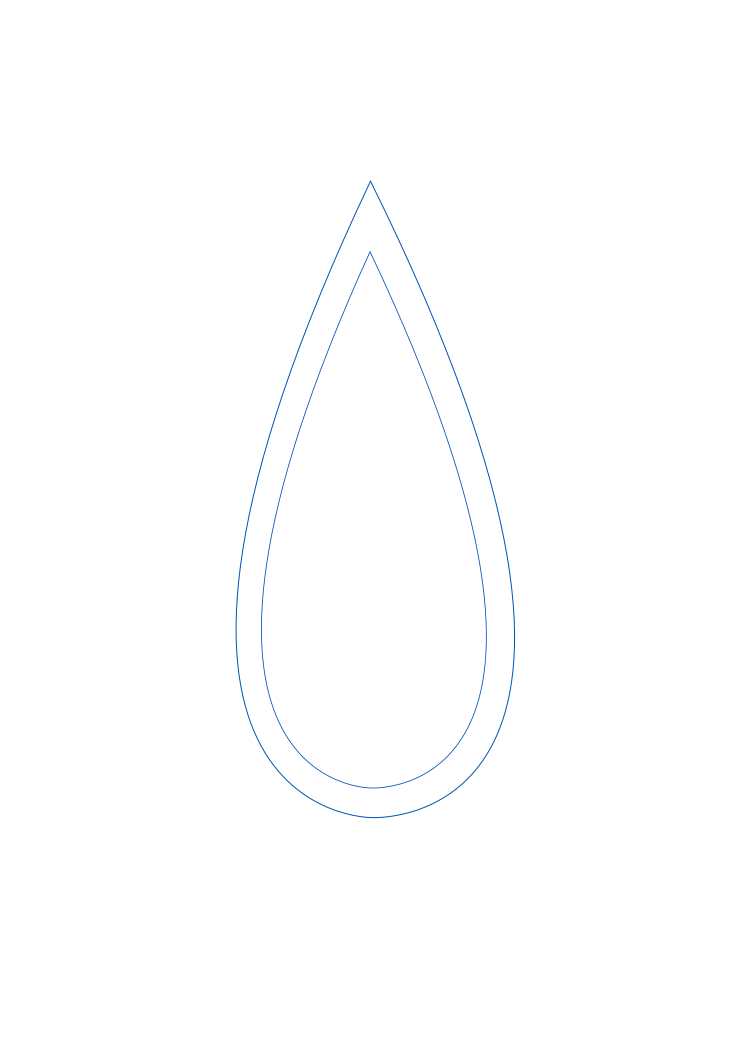

So, I have absolutely no idea what I'm doing. I'm learning as I go and have been looking at tutorials but I can't seem to figure this out.
I understand how to do a simple fill, but I only want to fill in the negative space between the inner and outer strokes of the water drop.
The stokes are on one layer and have been grouped.
I only want to color in the 'out line' of the drop.

Will you give a color for the inner part ?
the answer is probably boolean operation (difference) in the path menu

Re: I only want to color in the 'out line' of the drop.
Or Path -> Combine.
^--may need to reverse one of the subpaths then for a good fill rule.
