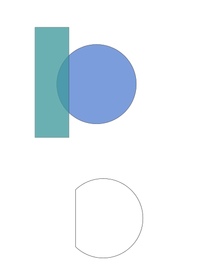

I am designing some gears and need a way to put a flat surface on the center hole. The motor the gear will go on has a flat on the shaft where a set screw matches to hold things firm. So I need some way of making a circle with a flat side.

If you want to 'flatten' one side of a circle, take a look into the boolean operations.
My guess is that you want to create something like this:
To do so, create a rectangle and a circle, put the rectangle above the circle, select both, then do 'Path -> Difference'.
