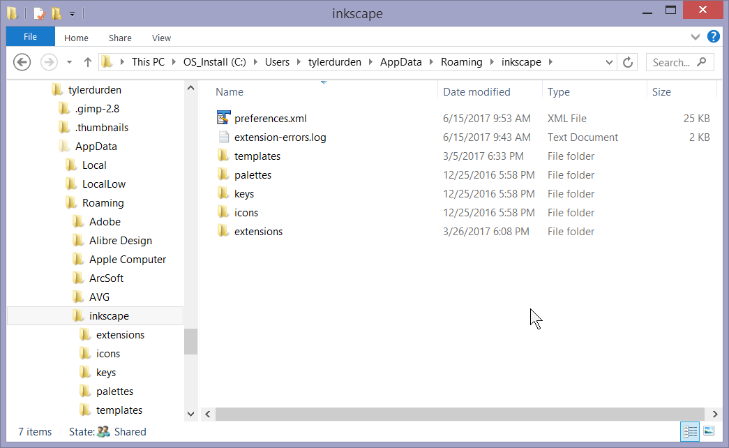

Can you now upload a copy of your preferences file? I cannot reproduce with my Inkscape, so I think some setting in Inkscape must be off to give you that result.
You can find the file if you follow the link given at Edit > Preferences > System > User preferences.

P.S. Ok I'm making headway ... I just learned that the Preference file is kept here:
~/.config/Inkscape/preferences.xml (0.47 and later)
So now I'm just searching around in my C: Programs/Inkscape for it. Not having much luck. If you have a tip for me, it would be appreciated. ha ha
Re: Bezier lines inconsistent width (Inkscape 0.92.1 r15371)
Set the file browser to display hidden files. See https://www.howtogeek.com/howto/windows ... ows-vista/
(the article is for Win 7, 8, and 10).
~ means your home folder. So C:\Users\yourname
Sorry - what I should have written, instead of the above two posts:
You can find the file if you follow the link given at Edit > Preferences > System > User preferences. (as I said above)

Another user had this issue a while back and this was the solution at the time:
Here's where I'd look for preferences.xml:
(FWIW, there are other Ai users here too...)
I had this problem on 64-bit Windows 7 and discovered it was caused by a previous installation of Python, which had installed an environment variable called PYTHONHOME in the system variables. Deleting this variable solved the problem. This isn't at all a satisfactory solution, because whatever it was that was previously using that environment variable now can't, but at least it makes Inkscape work.
He is how to get rid of it:
- From the Start menu, type "System" and select System from the list (under 'Control Panel').
- Click on 'Advanced System Settings' from the panel on the left.
- Click the 'Environment Variables' button at the bottom.
- Under 'System Variables', scroll down until you find a variable called 'PYTHONPATH', write down what its value is, so that you can recreate it if you need it, and then delete it.
-Close and open Inkscape, and try to see if it's worked. (There was no need to restart the computer in my case).
