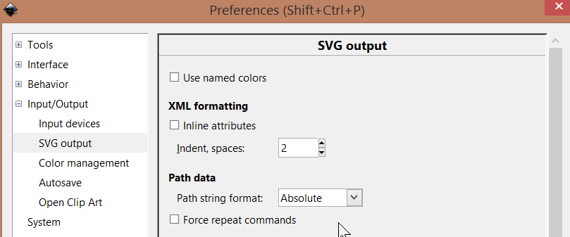

Hi Ponny,
Please try setting SVG output string to Absolute.
This stops the additional nodes on your test files here.

Re: Unwanted duplicated nodes
Please try setting your preferences to "absolute " as described in my post above and let us know if that helps.
TD
TD
Sorry, but I can't find in Preferences window this "absolute".
What should I set to absolute?
Did you see the indigo Pony, when he came from other side wall of the night?
In the preferences panel, look for
Input/Output
TD
Input/Output
- SVG output
- Path Data
- Path string format:
TD
I made this test right now:
Red path with 8 nodes.
Duplicate and moving to the right.
Result:
For Optimised and Relative I get 9 nodes.
For Absolute is still 8 nodes.
What now? Should I go to Absolute and problem solved?
By the way, what is this setting in fact? Maybe something about coordinates of nodes on the page? Or something absolutely different?
Result:
It describes how Inkscape saves the coordinates of paths. It can either add a 'transform' around it, when an object is moved (something that basically says 'this path at location x,y is now moved by 10 cm to the left'), or it can recalculate the node positions and save those to the file.
Absolute - always recalculate
Relative - always with a transform
Optimized - depends on the path, it's optimized for file size.
