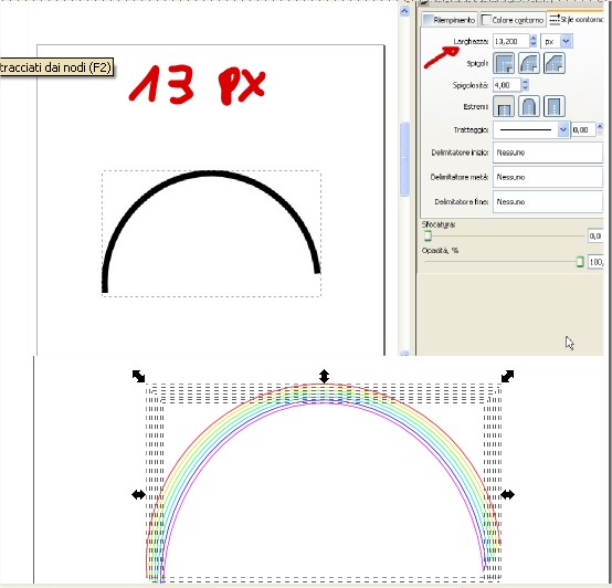

Re: contour width with Stroke style and disable stroke(?)
Having cloned the curve, not to remain at 3.3 stroke
why?
I want to increase thickness
example
why?
example
- arcopixedl.jpg (53.89 KiB) Viewed 2257 times
I understand now. I'm playing with the dev build and none of the numbers add up when it comes to the stroke thickness when you follow that tutorial. There's an option that can toggle if strokes should scale or not when scaling an object, but it doesn't seem to apply to clones. The reported stroke thickness of a clone is not correct--but when you unlink the clone it does appear correctly.
For the purpose of that tutorial, I don't think it matters that the stroke thickness changes slightly as the clones shrink.
