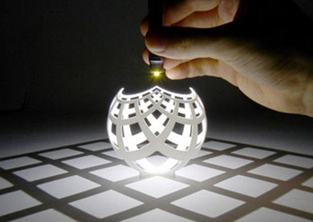

Let say I have a 3D object which gives the determined shadow.
For example, the shadow is the set of squares.
Is it possible to model the 2D scheme in order to create the 3D object from a paper in Inkscape by built-in functions?
As a result, I need to obtain the scheme in Cartesian coordinates (X, Y).
How to draw the 2D scheme from the given shadow?

Re: How to draw the 2D scheme from the given shadow?
Is that photo, realistic? You mean the curved bars on that sphere actually create a perfect square grid in shadow? Wow!
And so, you want to enter some equation into Inkscape (or other program) which will produce something in 2D, which can eventually be glued up into that sphere?
I doubt if Inkscape can do that, but I would also echo to look at Blender or other 3d graphics.
If you already know the equations, you could look at Extensions menu > Parametric Curves or Function Plotter. But if you don't know the equations, then Inkscape can't formulate them either.
That photo above was showig a 3D printed object. Which is depicting how the stereographic projection works.
Parametric curves would hardly work.

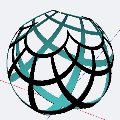

Building that mesh is quite easy even in a subdivision poly-modeler (macOS Cheetah3d used here):
But if the unwrapping LCSM/ABF+ algorithms are useful for building the real thing is at least questionable.
When mesh and Windows is available https://tamasoft.co.jp/pepakura-en/ might be the way to go then.
