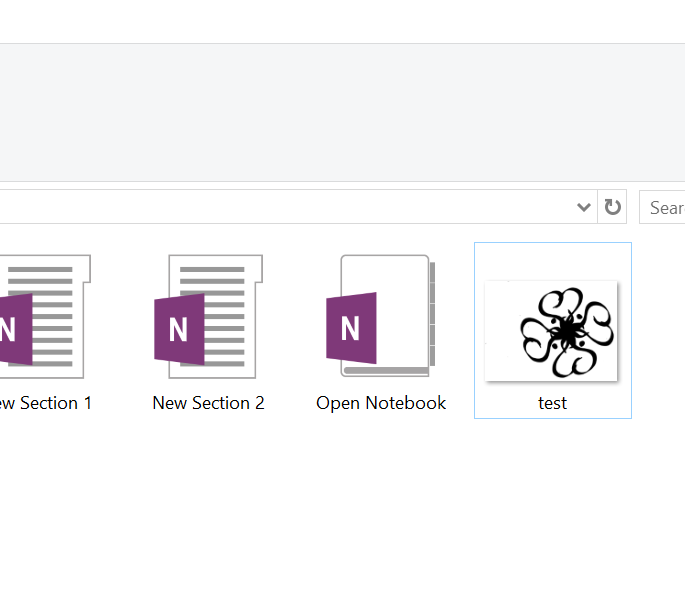

Capture Thumbnail... Screenshot the file folder where the test document is saved. You can see the drawing clearly in the folder view.

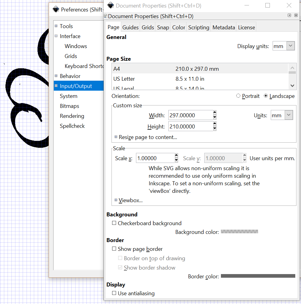

Capture of Inkscape Page Properties

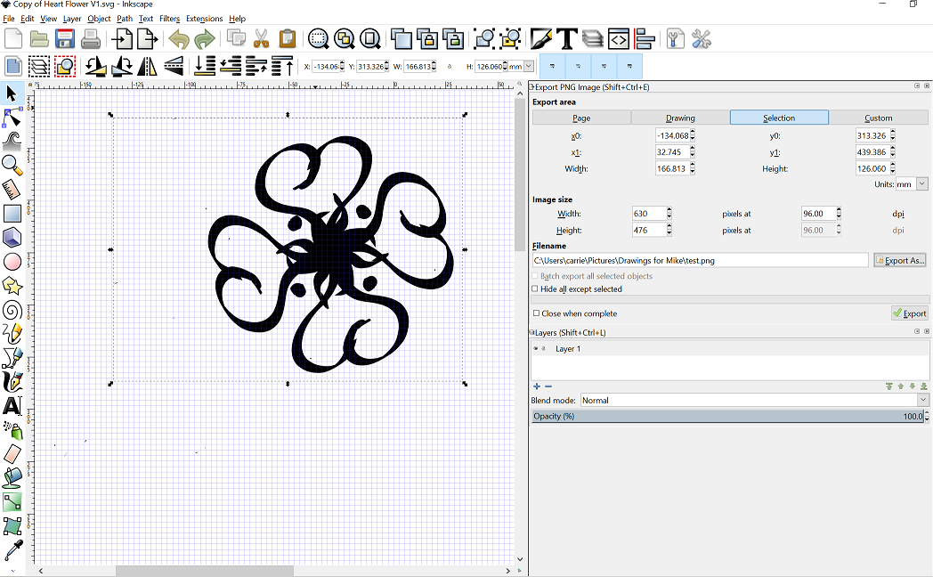

Capture of Inkscape Export

Capture of Page Properties
https://www.dropbox.com/s/tqg28i3wqliiv ... e.PNG?dl=0

Actually I just had a thought -- maybe those tiny object do have something to do with it. Can you share the exported PNG, please? Not a screenshot, but the actual PNG which doesn't display properly.
Nevermind about providing the PNPG, I see what you intend to export in one of your screenshots.
Here's a screenshot showing some of those tiny marks. Try deleting those extraneous little marks, such as those circled in red. And also, try filling in any tiny open spaces, such as those circled in blue. Then try the export again.
No promises, it's just a hunch.

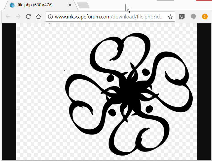

Here is the png
I did delete all the extraneous paths, thanks for that.
Here is the png
- test.png (25.01 KiB) Viewed 2125 times
Re: File-Export PNG Image = Newbie Blues
That file seems to have transparency.
So... where are these images going to be used? You might need better software than MS Photos.

Here is the view when changing the background color in SVG and exporting, so I guess the transparency is working.
