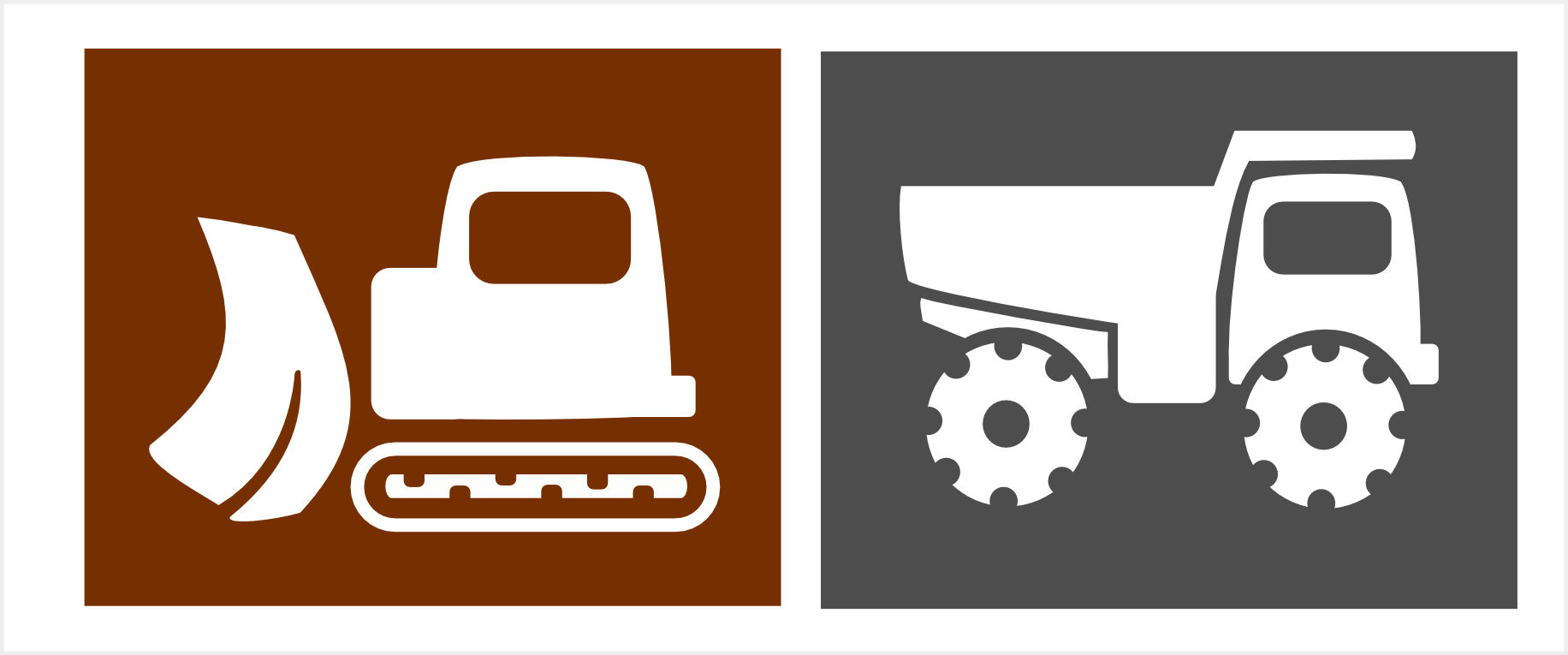

I've been having trouble printing my pics and it's actually getting worse! I have an Etsy shop where I sell my artwork, before when I would try to print my logo on the back of a page it would be hit or miss if this particular image would print. (When I reduced the opacity to 75%, if I changed it to 100% it prints everytime, which isn't what I need) However today I printed several different pictures from one file (I simply move one image into the 'page' area, print, and move on to the next) but now it won't print one image. I tried copy and pasting it to a new Inkscape file to no avail. It is sending to the printer but it's as if it recieves a blank sheet and doesn't even load the paper.

Sooo...Since the pic I was trying to print was a simple image on a background I traded the image on the background of another I had printed earlier. I changed the new background to the color of the previous making a 'uncopied' copy. The image printed, but only the brown background. I'm switching to regular printer paper to test this problem on because I've already wasted at least four sheets of my good paper on this mess. What is going on?!?
- Two images
- C for Clark.png (60 KiB) Viewed 1729 times

I got the picture to print but only by going to an older file of the same pic. I still don't understand what is going on, I've printed the image at least a dozen times.
I've attached the file for you, the power point print came out skewed because of margin issues. Grrr, I really don't want to have to go to another program to print.
