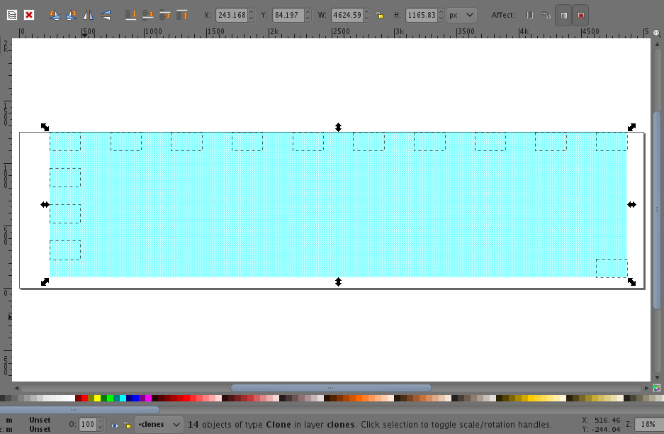

The drawing redone using one original group (with the 510 hexgons + 1 rectangular path) and a grid of 19x8 clones (152 clones in total) results in a file size of 152 KB (remember: the original file was 17.9 MB):
- Note: I do not recommend to open that drawing with current stable Inkscape 0.48.2 (there are simply too many paths to be drawn (closely overlapping or with coinciding edges) - the lower file size doesn't change that fact).
Note II: The original group is hidden on a separate layer -> only the clones are visible (and the stroke of the rectangle in the original group has been unset)
Recent development snapshots (>r10588) I would only recommend with optimized builds (not debug ones without optimization) until the calculation of stroked paths has been sped up [see 2)]. Even then you probably want to find ways to optimize drawing such grids (fewer elements, no redundant edges) if you plan to create your actual drawing on top of it (using the grid as layout / snapping help.
As seen in a recent development build (takes about 40 sec to open the file on a 32bit system with 2.4 GHz Intel C2D and 2GM RAM):

- 19x8-clones-r10640-osx.png (214.2 KiB) Viewed 9521 times
