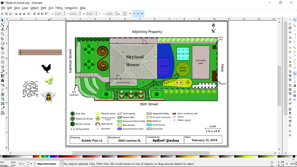

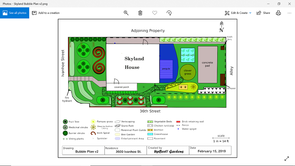

Heres a screenshot from Inkscape and screenshot from the PNG file when I open it in Photo Viewer (Microsoft). The layer showing the roof of the house changes to white, and several of the elements in the legend appear to be a different color/faded, and the text is less defined/faded. But yes it does seem to only be happening with layers/elements that aren't at 100% opacity and that have nothing behind them.

if you shared file it would be easier! This way is just slow and trial and error...but try editing your document properties to have opaque white background maybe? Are any of your layers set to screen or multiply? Also have you tried opening the png in a browser and not in photos, which is optimized for jpegs
calebjellyfish
- Posts: 3
- Joined: Sun Feb 17, 2019 1:14 am
Re: PNG export quality
Ahh, druban you are the best! I just changed the whole document background to white instead of transparent using the properties menu, that fixed everything. Never would have figured that out on my own. Thanks for the help!!
