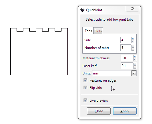

It can quickly add box tabs to objects.
Target material size and other mechanical properties are configurable.
Mating slots can be generating using a path as a guide.
Not a replacement for the excellent Tabbed BoxMaker extension, this is just a quicker solution for when you just want one or two sides of tabs on an existing structure, with matching slots.
