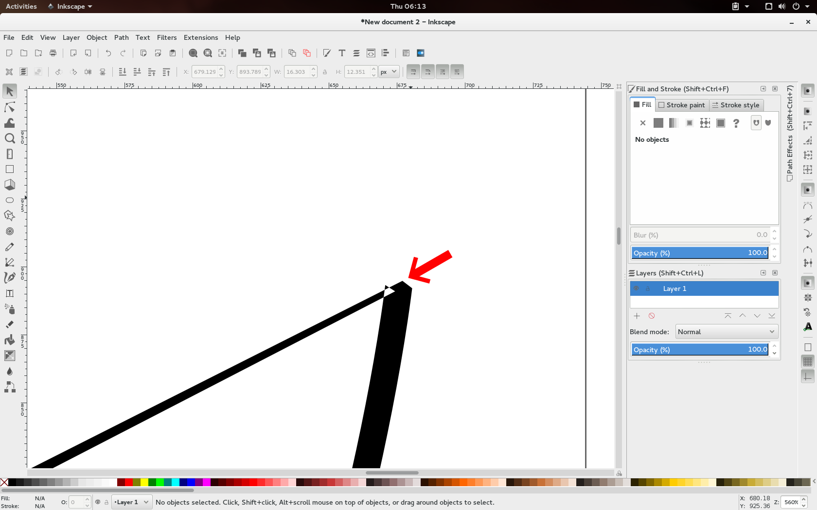

After upgrading Inkscape to latest stable version (0.91) I got a serious problem with Bezier tool in Ellipse mode which explained in blow images.
Thanks in advance for any help.

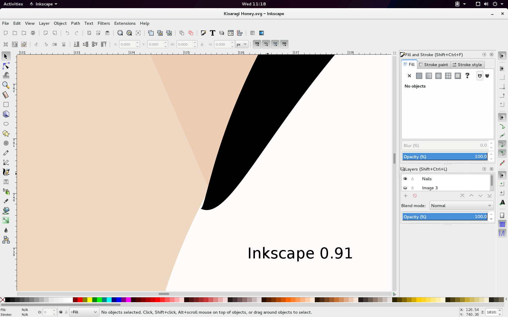

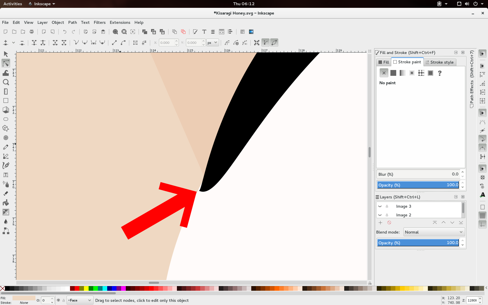

Thanks for the reply brynn. As you can see in first image the tip of bezier must follow the whole thing not the other way, it's like twisted somehow. And in the second image start node cross the end. And sorry for use word "mode" instead of "shape"!
Re: Bezier Issue
Well, for the 2nd one, and maybe for the first one too. But for sure, the 2nd one, if you use the Ellipse shape, we would not expect to see those sharp corners at the end. I wonder if it's possible the path effect was removed somehow, after you upgraded?
The first one does not have very much of a point, but it's still a little point there, that I wouldn't expect to see.

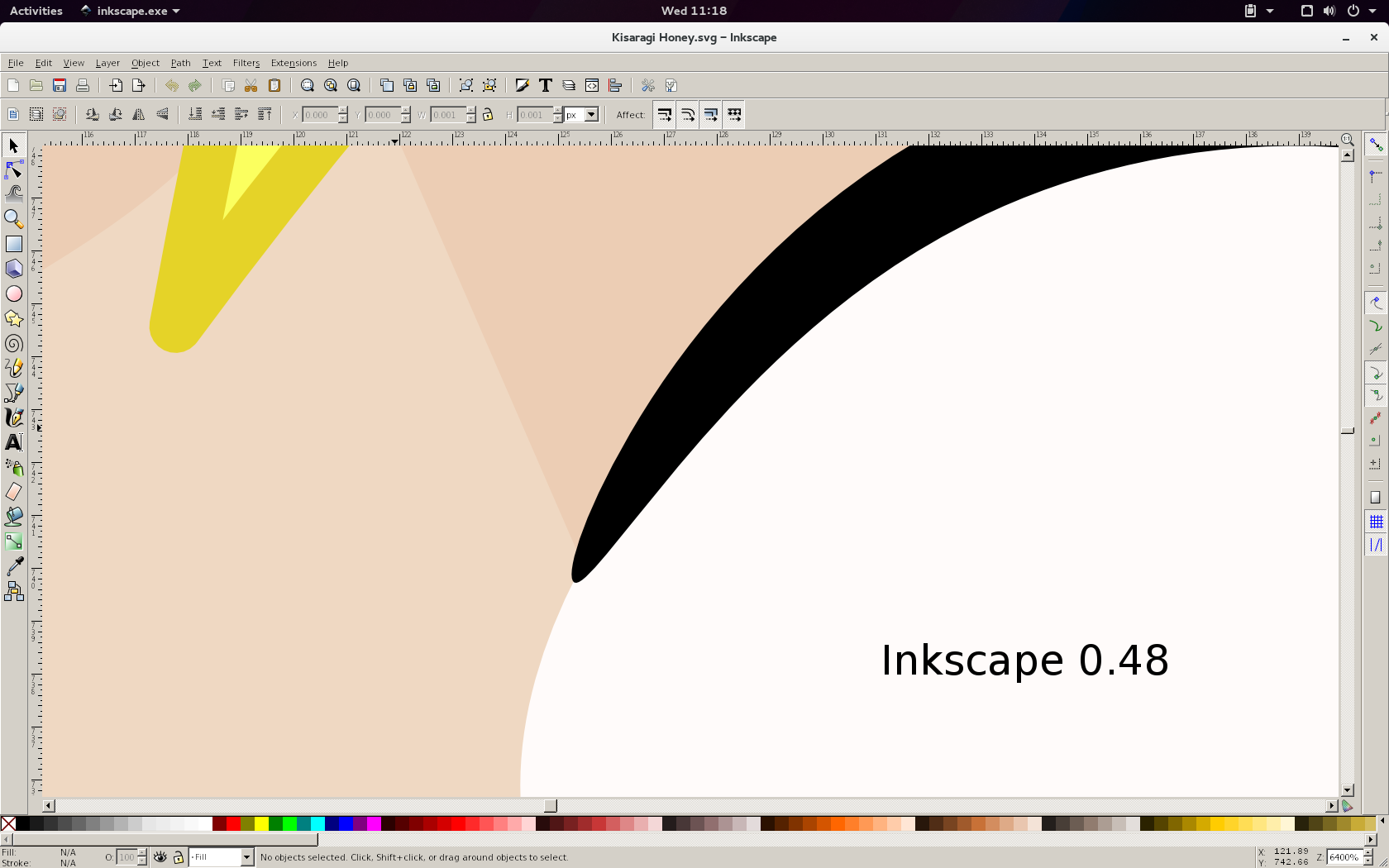

Excuse me but you think I don't know that? this is screenshot of first image which I just opened with both Inkscape 0.48 and 0.91.
Inkscape 0.91
Inkscape 0.48
