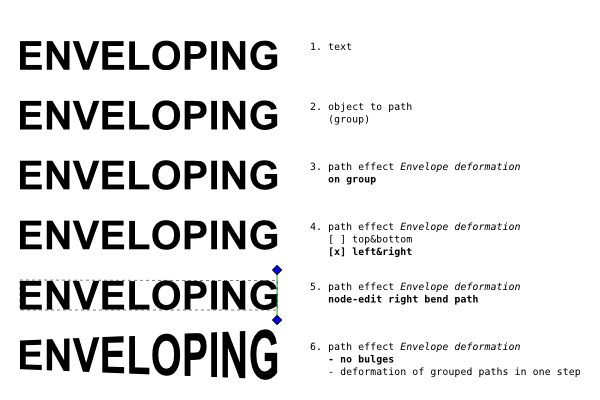

vwanweb wrote:Setting the Envelope per object will eliminate the WEIRD bulges you are refencing
"bulges" can be avoided by
- apply LPE directly on group
- deactivate top&bottom bend paths
- node-edit right bend path (select both nodes and scale with '.' (keyboard shortcut))
Note: Envelope Deformation is not a 'Perspective' deformation (Extensions > Modify Path > Perspective).
- LPE-Envelope-on-group-1.svg
- (75.48 KiB) Downloaded 213 times
Re: Incongruent skewing / Foreshortening of an existing object
You can even use the text object itself (allows to edit its content as text while the path effect gets live-updated) by stacking path effects (Pattern-Along-Path + Envelope-Deformation):

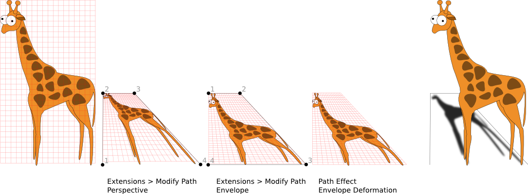

I am interested in this topic as I have run into the very same situation where I wanted to create the shadow of a character I drew. (see attached result)
In this case, I used some envelope extension to accomplish it where I drew an oddly shaped four-sided polygon and selected the two things and using "envelope" it deformed the object into the shape I wanted. The problem was that there was a LOT of trial and error and in the end, I don't really remember how I arrived at the result I wanted. I seem to recall it had something to do with the order of the the points I drew in the envelope polygon because my first few attempts ended up rotating the figure in strange ways.
What I would like to be able to do is select my grouped object and then play with the bounding box's dimensions as I think that would be a more natural approach to what I think would be a common situation.

- erroneus-kirin-variants.png (157.11 KiB) Viewed 6082 times
Wow! You can say SO MUCH MORE in pictures than you can say in words. Thanks to ~suv for that fine example! With that, I was able to understand exactly what I was trying to do and what I was doing wrong. Most importantly, I was actually closing the path I was defining which was completely unnecessary. The numbered points also make the process extremely clear. This is a useful lesson I will remember into the future as it makes lots more sense now than ever before. (though it was neglected to say what was thought of my giraffe picture... oh well, fishing for compliments never works well for me... I usually end up with something closer to the truth.)
