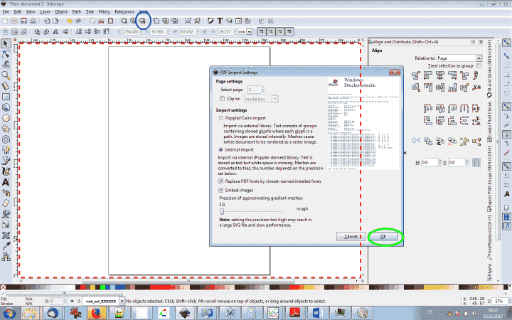

I am pretty sure that there is a simple "rule" where the imported content is placed.
My guess is that the last position of the mouse or mouse click seems to determine where the imported content is placed.
a) if the mouse was positioned within the visible window (indicated by the red dotted rectangle) the center of the imported object will be at the mouse position. Even if you are clicking "OK" in the import dialog as long as the click is within the dotted rectangle.
b) if the mouse is outside the red dotted area the imported object is centered within the window, i.e. within the red dotted area.
So, if you want to have your imported object always centered on the page, make sure that
1. your page is centered within the visible window by pressing "Zoom fit page into window (5)" (blue ellipse)
2. your mouse position or mouse click is located outside the red dotted area (e.g. green ellipse).
With this, I always got the imported content centered on the page. Hope it also works for you.
