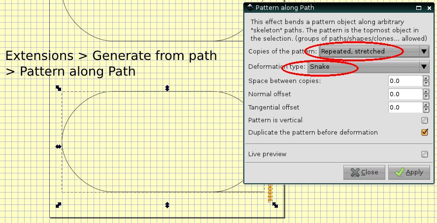

Hi hockeymd,
Welcome to the forum.
Inkscape doesn't use 'art brushes' in the same way.
However, there is an extension that can do a similar job.
I've used a thinner 'track block', but you can play about and see what you get. Sometimes the extension gives an odd output, try again if this happen.
Have your 'track' as a single path, and group all the objects in your block. Ensure the 'track block' is in front of the 'track' - this lets inkscape know the 'track block' is the pattern. Select both items and go to
Extensions > Generate from path > Pattern along path
Ensure 'repeated, stretched' and 'snake' are your options and press apply.
I've not included the number, so you with need to play about a bit. Hope this helps ; -)

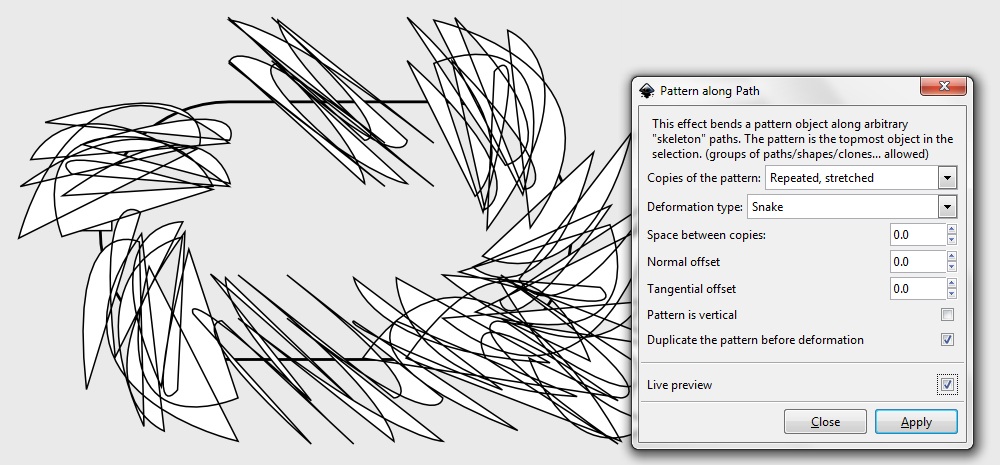

Thank you for your help. Unfortunately, I'm still missing something. I wonder if there's a problem with my track "path" to be used for the "Pattern Along Path."
I still get repeated distorted copies.
Here I've used a simple square with black border and white fill along a simple oval path I created initially with the rectangle/square tool, then rounded the corners to get the oval shape. I then used "object to path" to change it to a path.
I made sure to have the square I want to repeat above/on-top of the track path.
any ideas?
-mark

Hi hockeymd,
Hhmmm...the problem might be with the pattern. You said it is a "simple square with black border". But it would probably need to be 5 or 6 squares, depending how many lanes in the track. And I actually can't make it work using generatemutate's steps. You'd have to use Single, Stretched, I think. But I can't get it to work.
But to be honest, that PAP extension gives me fits

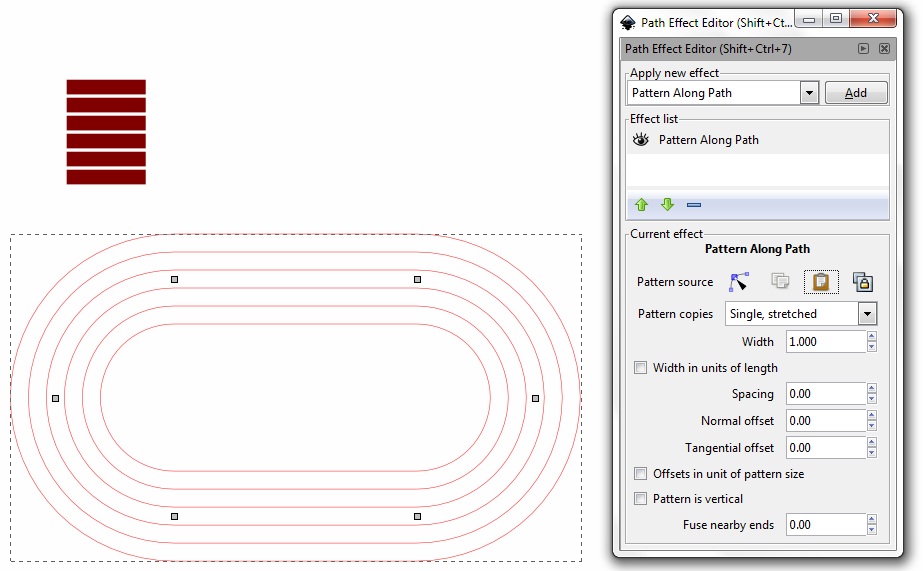

I find the PAP path effect (LPE - Live Path Effects, Path menu > Path Effects Editor) much easier to use. Groups can't be used with the LPE, while they CAN be used with the extension. But I think it should work to convert the 5 or 6 squares to a compound path (Path menu > Combine). Since the LPE is "live" you can tweak the settings on canvas, without having to undo and re-apply the extension every time you want to change the settings. And it doesn't matter which piece is on top.
Here's what I've worked out, with only 4 lanes. Squares converted to paths, if not already (Path menu > Object to Path), then combined (Path menu > Combine):
Select them and Copy.
Rounded rectangle to path (Object to Path). Plus some node editing to make the little "tail" piece. Then Path menu > Path Effects Editor > PAP > Add > Single Stretched. Then click the Paste icon (in the PAP effects dialog) Results:
So that's pretty close to what you want, except for those vertical lines at the beginning and ending of the path. Try again -- first, remove the path effect from the path. Then edit the 4 squares to look like this:
And here's that result:

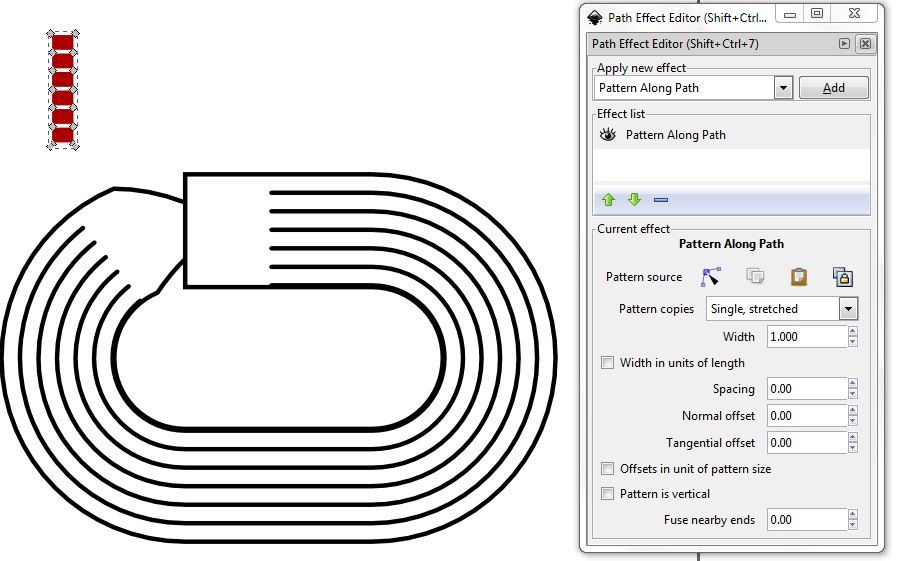

Thanks, brynn. I think I'm getting closer. I tried to reproduce the steps you described and I get the tracks to repeat around the path using LPE. However, I get a strange narrow or twisted at the top left. See below. My track path is a simple oval (created rectangle, curved the corners, then object to path.)

Re: Inkscape to create running track
Could you attach the SVG file of the above? I can't tell by looking at the screenshot, what might be going wrong there. I don't understand why it's not red, like the pattern. Oh wait....I think I see some extra nodes in the pattern, which might be part of the problem. Do you see them, there at the bottom of the pattern? (It looks like there are at least 4. That's because when 2 nodes overlap precisely, the node shown is half the usual size of a node. If 3 nodes are stacked on top of each other, the node looks like a normal node. So there could be other extra nodes as well. Any odd number of stacked up nodes looks like a normal node, and any even number looks half the usual size.) If fixing that doesn't make it work, please attach the SVG file, and I'll hopefully be able to sort it out.

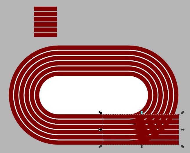

Ok, I tried it again, except with a colored pattern, and I don't understand why the color doesn't get applied to the path. But it can be applied later. So try it exactly like how I posted above, with only the black strokes pattern. Then after you have the "track" with black strokes, you can change the colors. Still no luck, upload the SVG
I appreciate your help, brynn. I'm still having the same issue even with what I think is a clean set of lines without extra nodes.

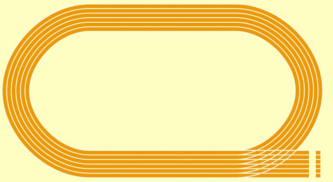

Wow, brynn, you're just too quick for me.
I think I've got it working now. The trick seems to be using just the single strokes without any boxes or borders as the main repeating track block.
Here's something like where I'm trying to go. I am VERY close, as you can see.
I just need to work-out the "fill" of the white lane markers in the overlapping sections and in the other open-ended letter sections.

Looks like the track 'red' is the stroke. I think if the white is the stroke it draws on top and the fill colour is under neath?

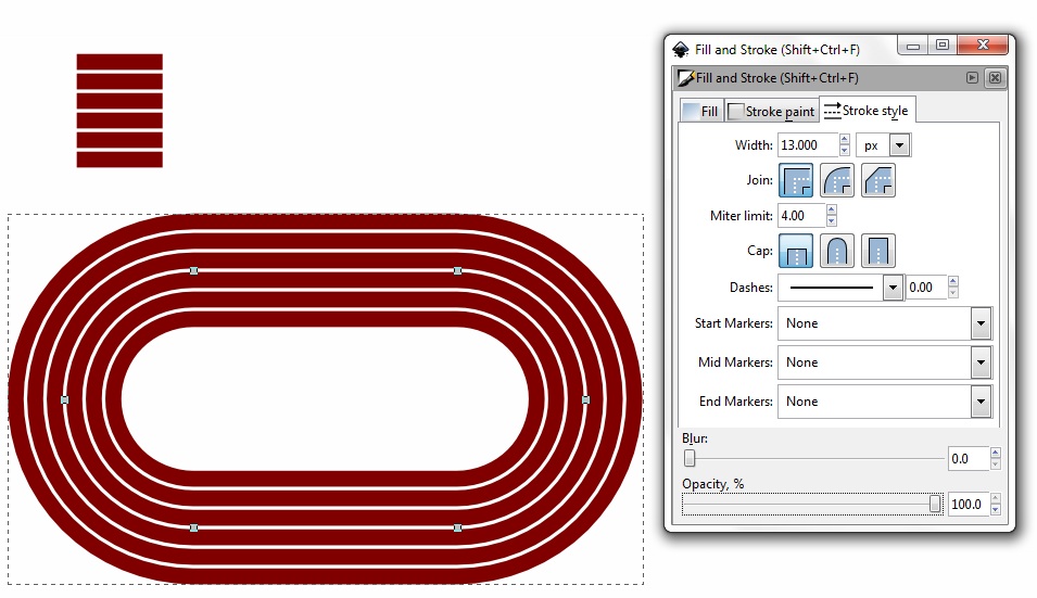

Ok, I think I have something worked out. It might not be the best approach, but it's the best one I can think of. This is actually quite an interesting problem to solve. 3 or 4 different approaches have come to mind, but this is the one that gives the best result (of the things I've thought of). Someone else may come up with a better way.
After you apply the PAP, duplicate it. Make the one on the bottom red, and make the stroke so wide that they touch each other (around 17 in mine). It looks like a solid fill, but it's not really. Then make the top one white, and the stroke might need to be 2 or 3. You might want to group the 2 PAPs together, if you need to move them around.
The only problem with this is that the inner and outer "lanes" are a little narrower than the others. But out of few things I've tried, this is the best.
Here's my file, to show you. It also has the track with the "tail" (remove the path effect to see it).
