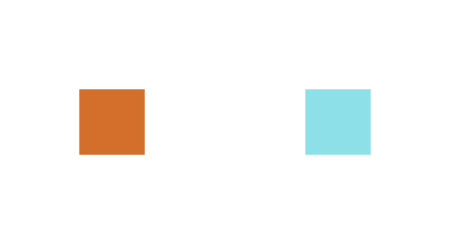

Lets say i need 10 squares with 8 nodes each, going from desaturated orange to sky blue and i dont want any complicated math (tiled clones *cough*).
I could clone a column or arrange 8 duplicates by hand for the shapes, but for the colours its getting a bit complicated.
I could interpolate the gradient and transfer them by hand with the dropper tool but its a bit tedious.
Maybe interpolate colour attribute in a group extension ?

Re: Interpolation Extension Bug ?
Maybe the trace feature of clones?
tylerdurden wrote:Maybe the trace feature of clones?
Interesting !
Funny how when the clones are adjacent, they look like they all have gradients... but they are truly solid colors.
