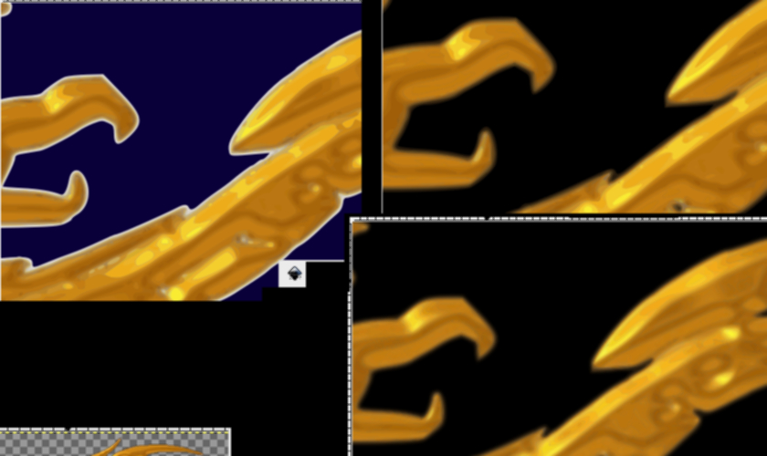

I was wondering if there was a script or plugin or something that can take my trace bitmapped image (svg), and rescan it for visible layers to be combined in there respective colored noded polygons, and delete excess nodes/polygons?
My problem is the stacked scans have too many layers to clean, and unstacked scans leave holes in the image only the background (original) png can fill.
I can go in and edit each layer, but if I make a 32 scan trace bitmap, that's over 30 layers to edit.
Thank you very much! Brother Jaso

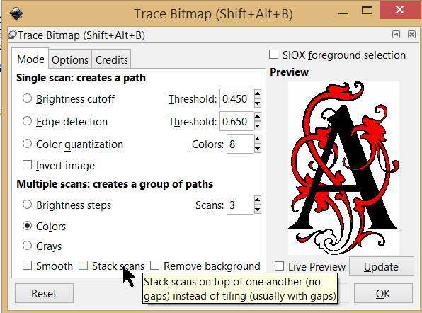

What do you mean by "visible layers"? I've never heard of Trace Bitmap creating hidden layers.
You could try to reduce the number of nodes by clicking Path menu > Simplify once. A second click will probably deform or distort the paths.
If even one click distorts the path, you can ungroup the trace results and select each path, one at a time, and use Simplify on them one at a time.
If that distorts the path too much, you can adjust the threshold for simplifying, so that it doesn't take as many nodes. See Inkscape Preferences > Behavior > Simplification Threshold.
But on that image, with that many scans, manual tweaking of nodes probably can't be avoided. A custom script could probably help somewhat, but I don't know of any.
There's a checkbox at the bottom of the Trace Bitmap dialog, to remove the background or not. Maybe you had that checked and didn't realize it? Or you could simply draw a rectangle yourself, and put it at the bottom of the stack, to create the background.
If this is a one-time task which you will be using Inkscape for, and you can share the SVG, I might offer to clean it up for you. But if you expect to use Inkscape a lot in the future, you may as well get used to doing it yourself
Just thought of something else. The larger the image you use for tracing, the better results you will get. So if you have a larger one that you can use, you can probably reduce the amount of manual work.
It seems like I heard about an extension that can move each path to its own layer. But I can't seem to find it. Maybe someone else knows where it is, or maybe I'm mis-rememering

Re: Trace/MergeVisible?
Yes, fairly common problem, but much depends on the original image.
Ooohh, I think I understand what you mean about visible layers now. You mean where the image is made up of the background (largest layer) and the next smaller layer/object/color is on top. And the next smaller one on top, and on and on. So you're thinking if the parts of the objects which lie on top of each other could be removed, it would make a smaller file. But if I do understand correctly, that would only add more nodes, and make the file even larger.
Is the PNG that you attached the same size as the original? Yeah, that's pretty small to be used successfully with Trace Bitmap. The larger and clearer the original, the better the results will be.
When you have time, if you could show us the original PNG, and share SVG file with trace results with us, we can have an idea how severe the problem is, and be able to give more specific suggestions.
Could I ask what you're planning to do with the vector paths? That might help us give better suggestions as well.
On the first glance, auto tracing a raster image sounds like a quick and easy way to get vector paths. But really, it takes a little time to get the right configuration, to get the best results possible. And it doesn't eliminate the need for at least a little manual work.

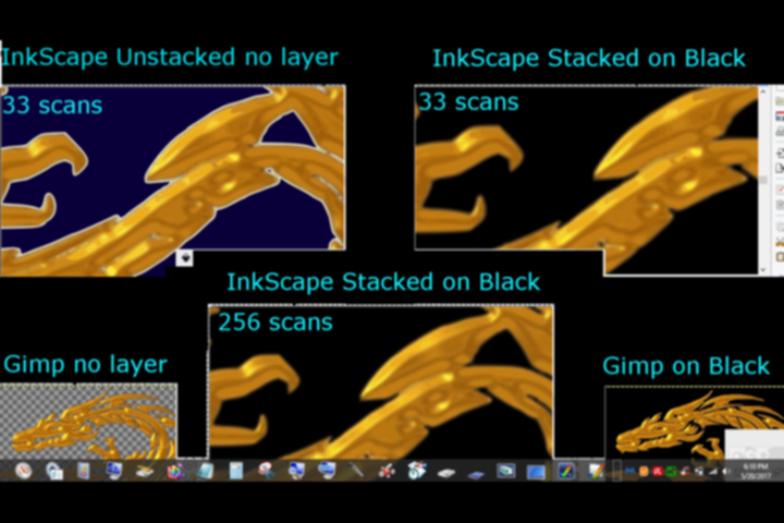

Just made second full response, lost due to taking too long and having to relog back in. LOL No worries, I copied and am pasting now...
Just made full response, went to full editor to add svg's, lost everything! LOL
K. Quick response.
Visible layers. Yes. I'd say 90% of the svg has layers spanning the width and height of the image which is unseen when stacked. (unseen from top would be a better description than hidden)
Simplify. YES. I like this. Did't know it was in the drawer! LOL Threshold Preferences. YES. Dialing in to workable undistortion. (Happy medium)
Remove background. I check here, it's not working. Not a problem simply move the svg up to select the original png at the bottom, delete png, & move svg back. Oh dang, just noticed I need to upgrade to latest version of Inkscape. It's probably my computer and not a bug. I'll reboot later or reinstall later and see.
The way I look at it, if I'm not manually tweaking, something's wrong. LOL Not sure if it's a matter of a scripted workaround or in the way the trace is projected. It looks as though it's going with the darkest colors on top to the lightest down. Maybe I'm thinking a 'double trace'? where the second scan takes that which is visible from the top & creates one new set of paths/nodes for each new colored polygon? In my thinking, this would create one top layer with an equivalent number of nodes and a disproportionately smaller amount of layers all knitted together.
No, I wouldn't ask such, unless you really wanted to. I've been exercising Inkscape probably 10 years strong now. (I think I just forgot about simplify)
Larger the image the better the trace. Repeat. Larger the image the better the trace. LOL Yes, found this out too, initially I test the boundaries of software. If I recall, Inkscapes capacity is only limited to my endpoint?
Yes square rectangle background to custom color trick. Just using that for this the other day. I use Gimp to compliment InkScape too.
Oh dang! I missed this, I was up to blacking out stages last night. An extension that can move each path to it's own layer? That sounds exactly like it!
Just regoing over your posts... Yes, I want to make a retrace of the svg itself. Now that I think about it, it would cut the number of nodes in exactly one half, and leave one layer. Or no, there would be an equivalent number of nodes minus the four corner nodes or so per layer.
Oh, no, I adjusted it with Gimp to make it smaller for this post. I'm including the svgs and png with this post.
I like to trace bitmap images for logos, art, maybe a video overlay, making a dvd right now whose menu editor allows for svg, DVDStyler.
Yes, I create from scratch. Yes probably shifted a gazilla, billa, milla, janilla, geon nodes over time. LOL Not doing anything point of reference critical like converting cyberspace into less than a mm accuracy. I had a huge success creating an icon recently. (I'll include that too) DPV/WinUAE taskbar, startmenu, all sizes actually, ico.
Actually, if one were to combine the resultant nodes, it might decrease the number of nodes to a factor involving the number of scans.
Do you forsee a trace svg feature coming soon to InkScape? or maybe a path to layer config?

[svg][/svg]Sorry, I'm making a double post trying to learn how to add images (png/svg). Files too large. (smallest 453 kb) ((that was zipped))
Total: 3.08 mb's (zipped).
I could contact you guys via gmail. I think it handles up to 20 gb's with GoogleDrive.
Managed to successfully upload here..

Actually, the traces are handled quite differently:
Bitmaps with transparency on the left, traced with three scans.
- 2017-05-19_14-31-48.png (36.89 KiB) Viewed 4724 times

Here are my findings..
Umm. 43 kb's too large. How did you put those images here? I click on Img above and I show two img's with the cursor in between. (??) I went to attachments (not sure if that is the way to call up an image to the post) and 43 kb's is too large.
OK. Figured it out, cut size of picture in half, jpg, not really doing the justice I wanted in describing how the 256 scan version is way more accurate than the 33 scan on black version. If I start off using the Gimp image (bottom left) on no layer, unstacked, InkScape adds it's own white layer, making the outline a lighter transition to gold. On the stacked versions, (using Gimp on black version bottom right) InkScape makes lighter and lighter stacks all the way down (inverse shadows I call them). So, unstacked makes an easy white stack to select and delete, but stacked makes each stack a full page color. And since I want to see the maximum quality InkScape can issue, the more scans (and hence, more colors) really tunes in the image(s). No problems here. Everything nice and crisp how I like it.
Is there a way to tell InkScape to use a black layer when tracing?
I'll try to upload a zipped folder of the above image so you can see the difference better..
Re: [solved] Trace/MergeVisible?
BrotherJaso wrote: How did you put those images here?
The upper image is an SVG hotlinked from dropbox.
The lower image is a screenshot attached/uploaded to the post.
BrotherJaso wrote:Is there a way to tell InkScape to use a black layer when tracing?
If the original bitmap has transparency, I'd try adding a black layer under the original using GIMP, then trace the new bitmap in Inkscape and delete the black scan.

Ok, I found this in the manual (possibly out of date, but I don't think so, for this particular issue).
Stack scans. The Stack scans option determines how the paths are defined. With the Stack scans box unchecked, the paths produced do not overlap; with the box checked, each path includes the area of the paths above it in z-order. The advantage of unstacked paths is that they are easier to divide into sub-paths, while the advantage of stacked paths is that there are no “holes” between the coverage of the paths. The differences between the two situations is depicted below.
So basically, having them unstacked would be doing the differencing for you. So you wouldn't have to go through that process (although I still don't understand why you did it).
But I certainly would suggest better wording for that option! Because it's way more than just stacking or unstacking! Even the tool tip doesn't really explain what it does. The only clue is "gaps" which is pretty cryptic.
