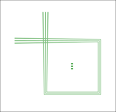

By the look at 1:05 it seems more of a pattern along path lpe.
Re: Parallel drawing (without closing paths)
Lazur URH wrote:By the look at 1:05 it seems more of a pattern along path lpe.
Good idea, but gives me slightly unexpected oddity:
- space_oddity.png (6.89 KiB) Viewed 2994 times
Hmm yes that seems to be intentional.
If it's for a paraxial core path maybe adding two extra bending nodes at the starting/ending wouldn't hurt that much.
Lazur URH wrote:Hmm yes that seems to be intentional.
Bend at a 90°angle and then clip the weird ends or what ?

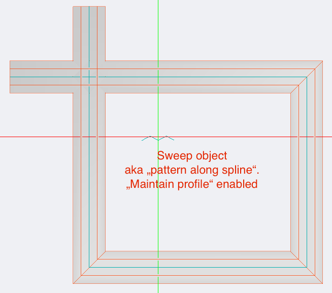

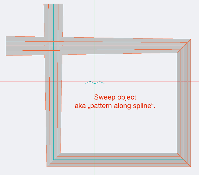

This effect seems quite common. We have to deal with it in 3d sweep-objects as well until we got an option called "Maintain profile".
